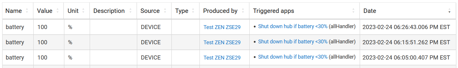

Down to three of 4 leds on the TalentCell.
Well, it's been 36 hours on the TalentCell battery so far, with 15 of them on hub alone and the rest including the ZSE29 motion sensor.
Still at 3 of 4 leds, and the ZSE29 is still showing 100% battery.

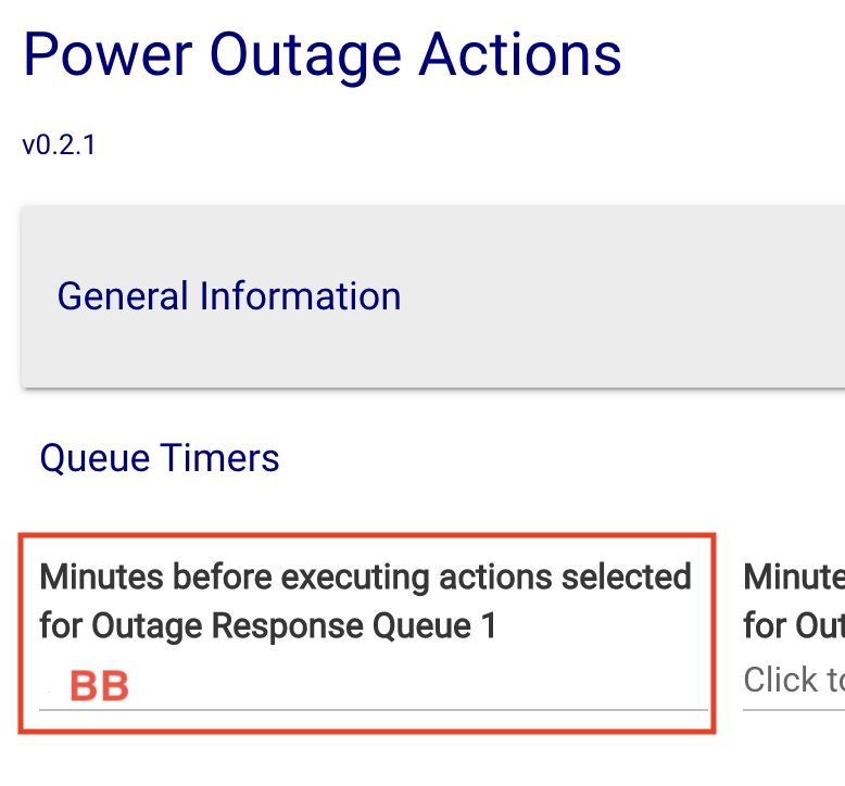

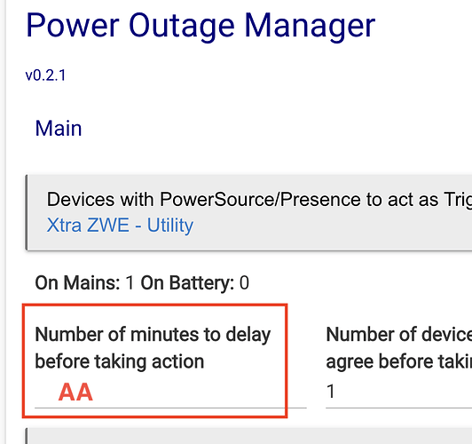

Question please... How are these two "delays" related -- On the main page, I think this first one ("AA") is an overall delay before doing anything, but then on the "Power Outage Actions" page, how do those 3 delay options (e.g. "BB") relate to AA?
Does the BB delay time start after AA expires? Or do they both start running at the same time? Thank you again!!
BB isn't activated until AA expires
Right on - thanks! Our power here is typically very stable, but unknown to me until I woke up, we had a brief outage ~2am during an ice storm, so I'm just trying to piece together what happened when.
I'll make an according tweak to my setup -- it seems I had BB running simultaneously, so this info is super helpful getting me squared away. Thanks again!
