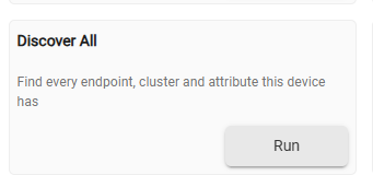

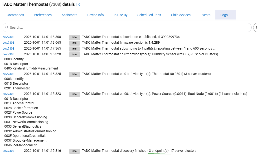

@ktd can you install this driver and run the 'Discover All' command?
This is the output for my TADO thermostat :
