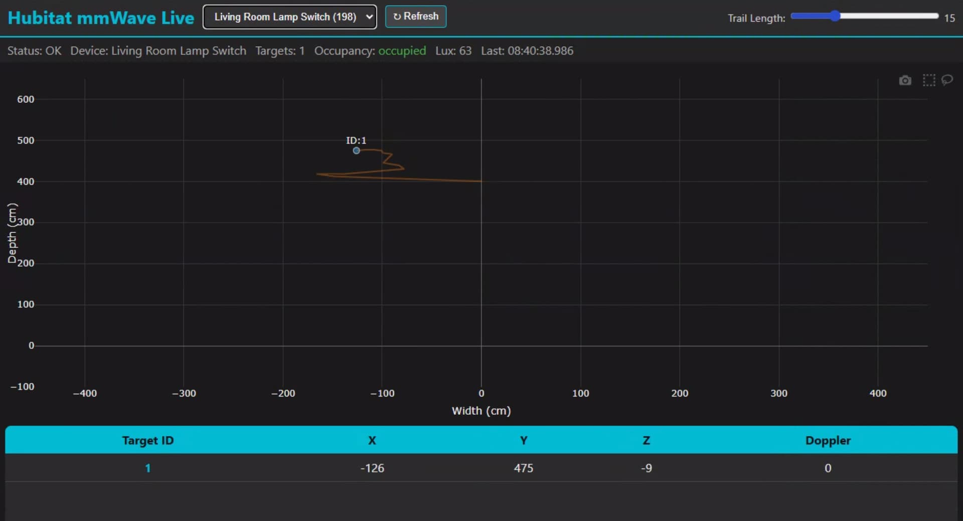

[BETA] Inovelli Blue mmWave Live Visualization
This is a community-developed web app that shows a live view of mmWave targets from an Inovelli Blue series mmWave switch (zigbee only). This is useful for testing/configuring the Inovelli mmWave parameters, including the detection zone dimensions as well as the interference area.
The app provides:
  • Live Plotly chart of target coordinates (X/Y) with target IDs
  • Target trail history (adjustable)
  • Table view of X / Y / Z / Doppler
  • Device selector (pulls device list from Maker API)
  • Occupancy indicator (motion: active = occupied / inactive = unoccupied)
  • Lux display (illuminance/lux attribute if available)

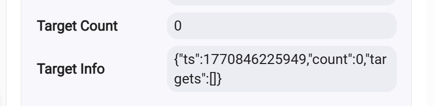

Edit: loaded everything up, added my switch to the maker API then fired up the tracker URL. It selected my switch and changed the state to "occupied" when I walked into the room but remained in a "no targets detected" state even though I had
  1. mmWave Target Info Report
set to enabled, preferences saved, and also ran a configure (all). Have 01-30-2026 driver. What am I missing?
Edit2: noticing that the switch targetcount state is also 0 when I'm in the room so maybe switch setting related? Sensor is definitely working properly however since room lighting controlled by my occupancy rule is triggering correctly.
When you look on the hubitat device page for your switch, do you see the attribute/state variable called "targetInfo" populating as you move around in the room? If not, then the issue is on the driver/switch side, as this app simply graphs that attribute as it changes.
roger. Figured that. I have the most current driver 01-30-2026 and firmware v1.0 loaded on the switch.
So you don't see that attribute populating? But you do see the targetCount?
I see them both but they don't change from 0 even when the room is occupied:

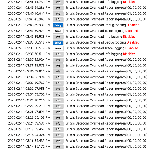

no, just getting what appear to be info level logs from target info reporting:

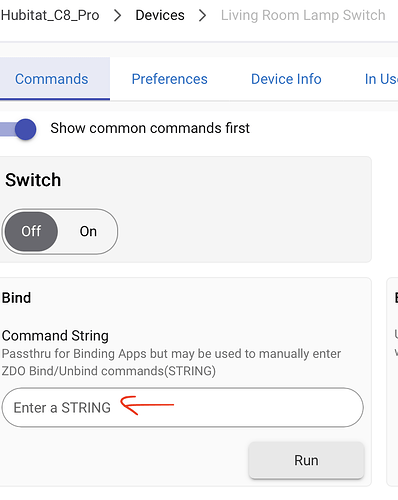

yeah it's not getting the needed zigbee binding, since you aren't receiving any of the coordinates from the switch on the mmWave cluster. I believe the driver is supposed to do this for you when you enable the target info reporting. But you could try to manually do it if you know how. See here.

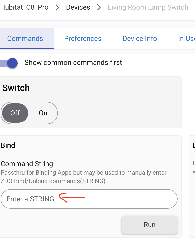

You need to Bind to EP1 Cluster 0xFC32
The Bind command on the device seems like it would work for this perhaps, though I haven't looked at how the driver parses the command
There's also other ways to do this in HE if you search the forums

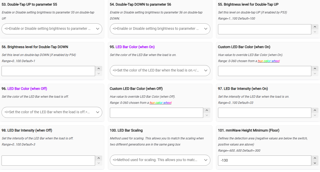

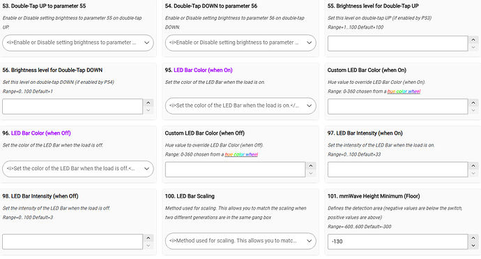

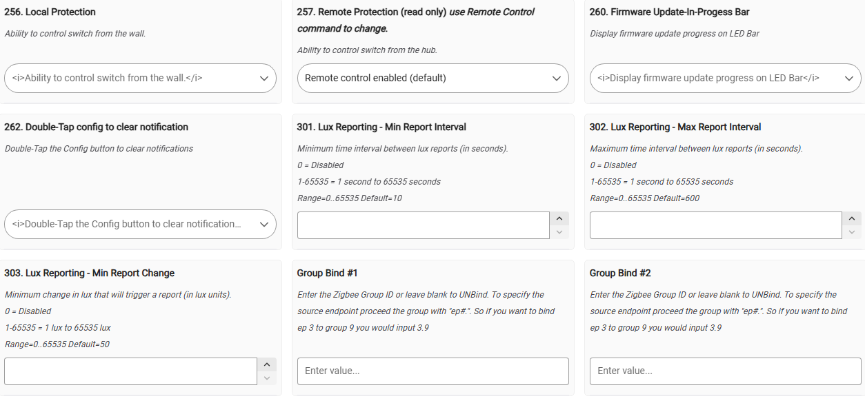

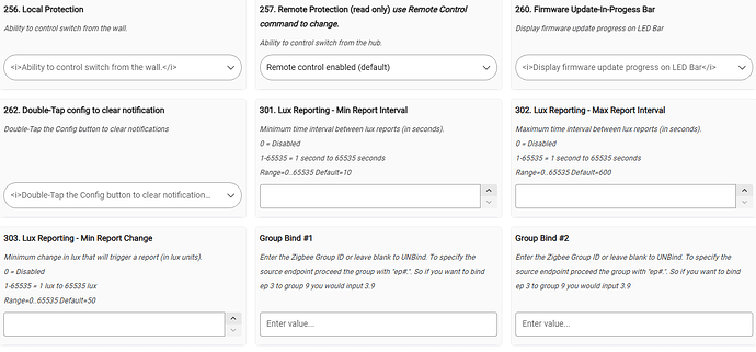

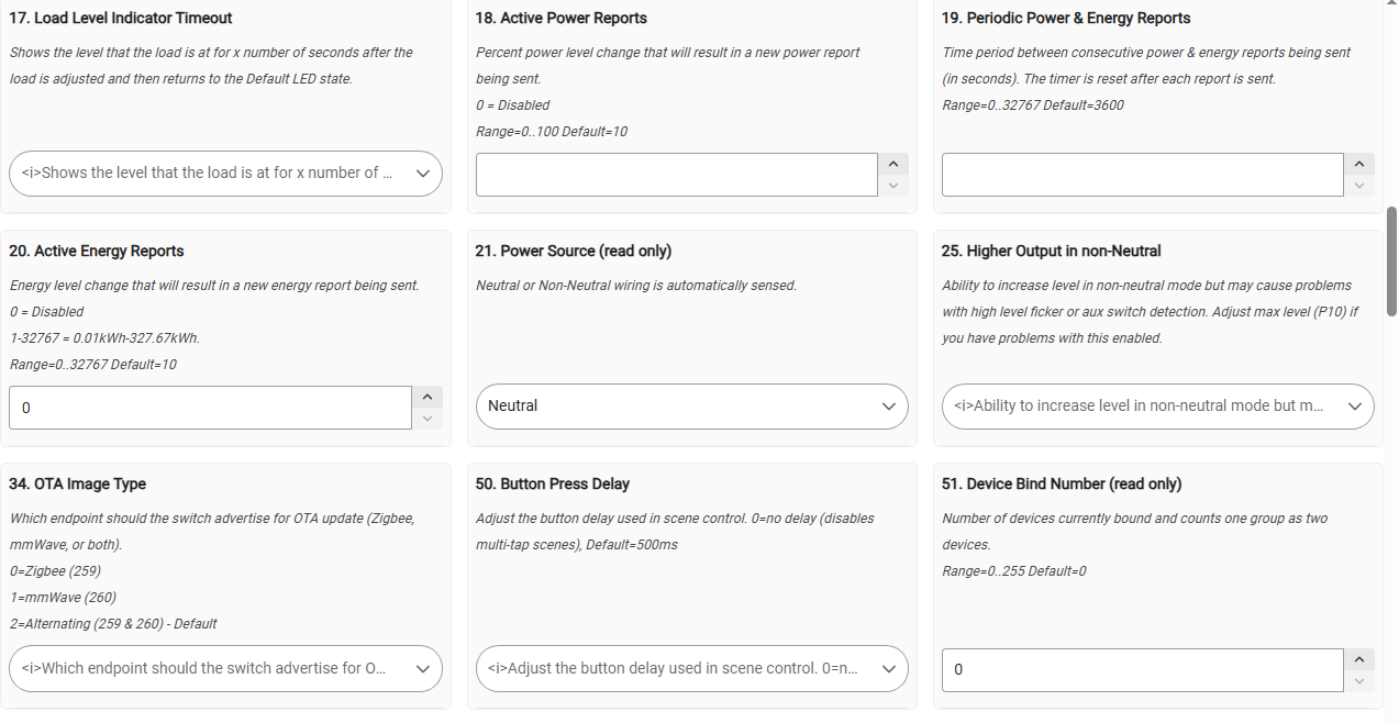

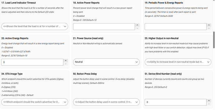

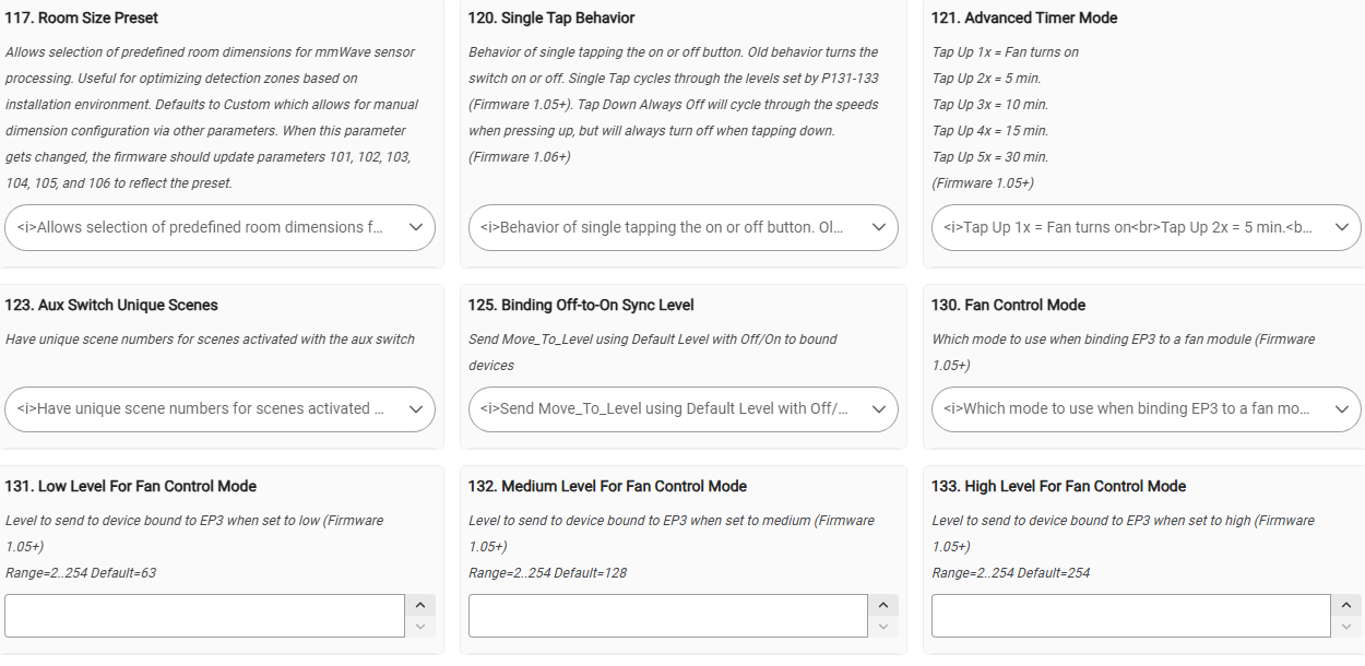

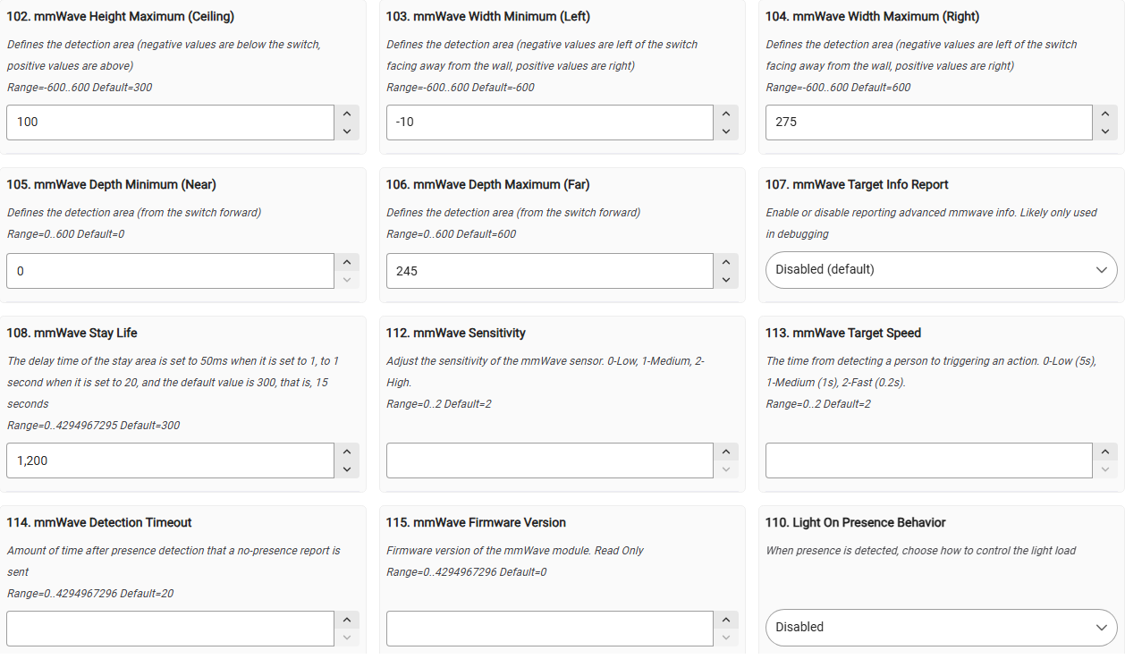

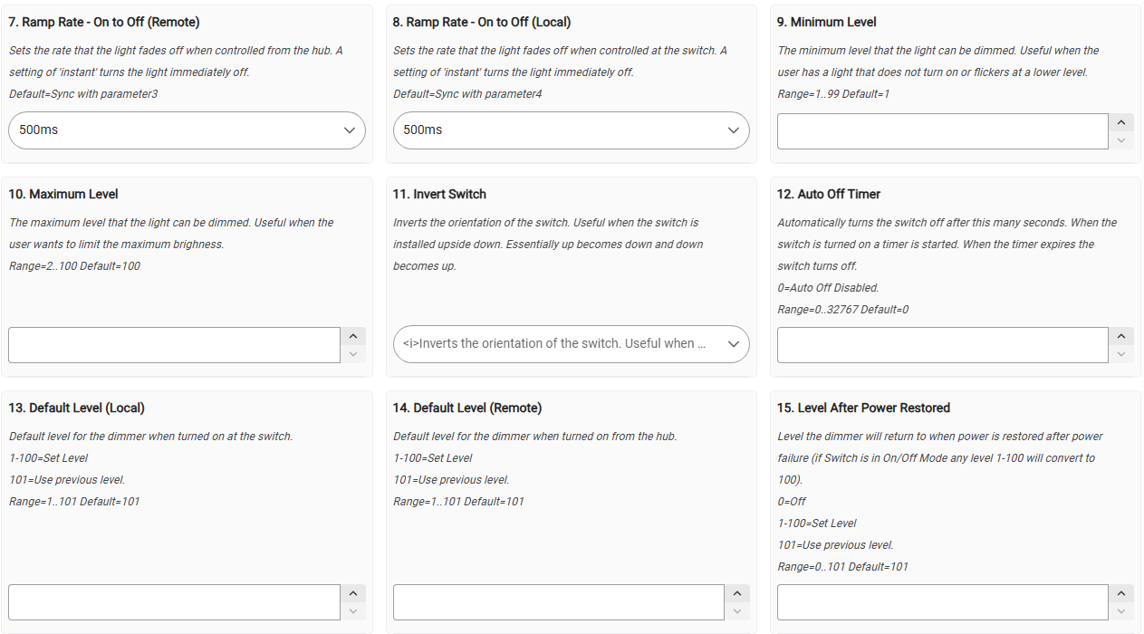

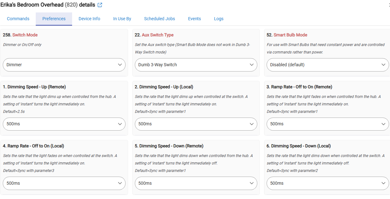

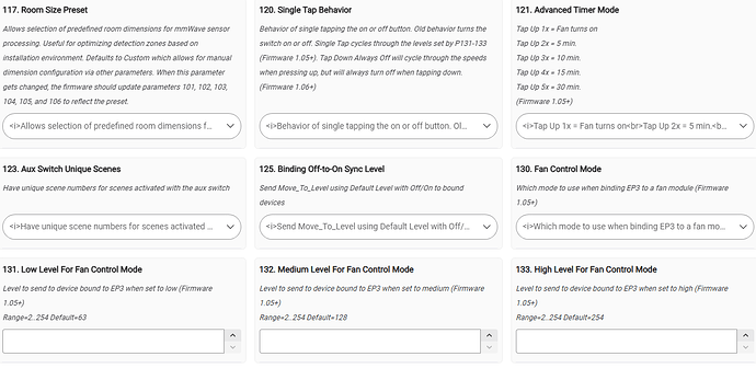

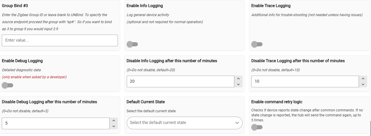

Ok, I guess we can go through prefs first then. Here's the full preferences settings for the switch:
My zigbee table is somewhat large (76 devices). How would you like to see that? Full screenshot of details in zigbee table or only certain columns? We could also switch to DM or a new topic if you'd rather not clutter up this one.
