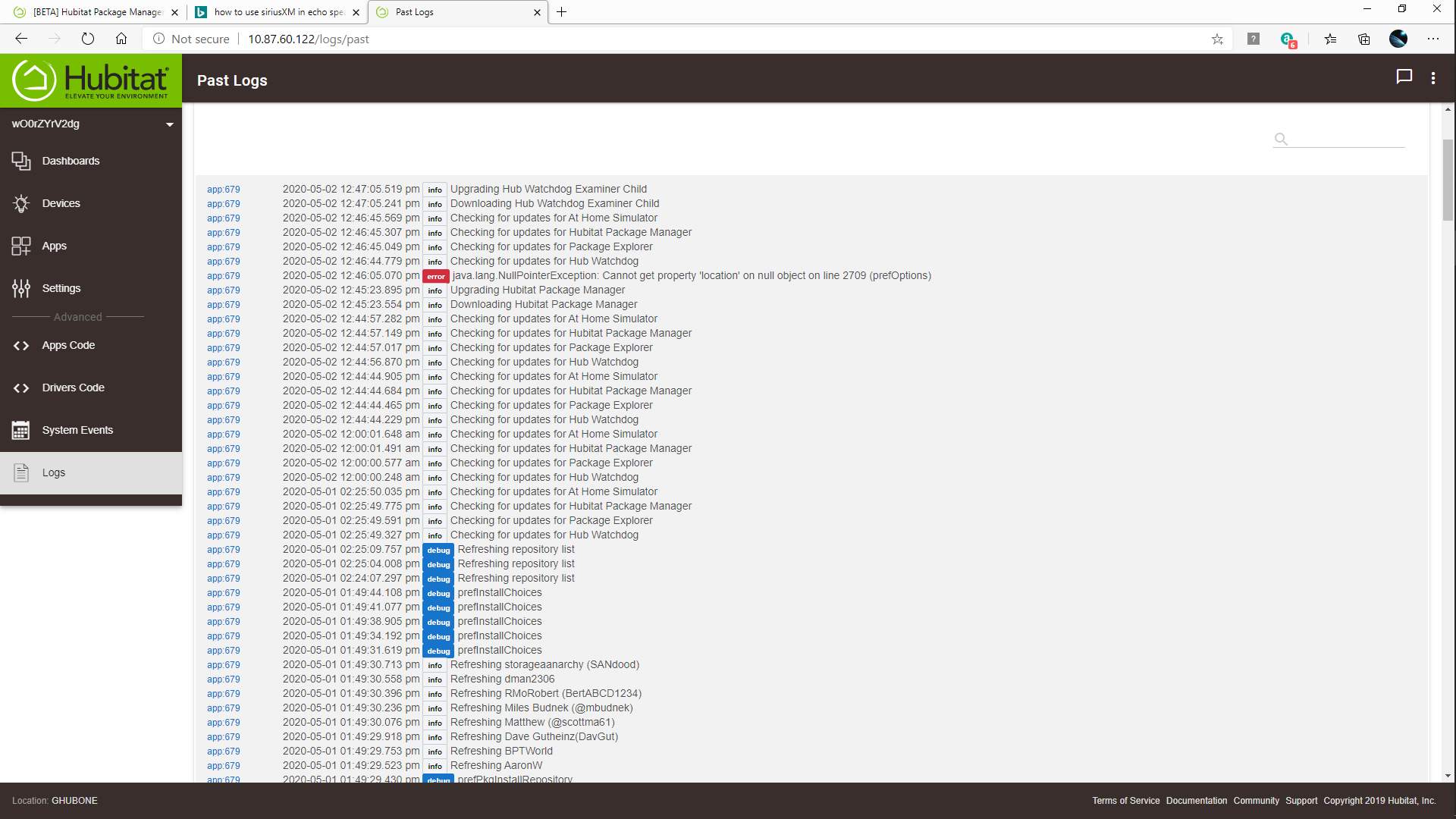

just performed an update on the Package Manager and received an error. However it appeared the update was performed. ( as shown below) The subsequent Watchdog update appears to have gone without error.

Yup, I'm on it, should have a fix tomorrow. It'd be great if we could get bug reports on github, it is much easier to track and to make sure I don't miss something just because I miss a forum post.

I just released 1.3.3 which fixes the null error about 'location'. I also published a sample manifest per @markus showing some of the various functions available now at hubitat-packagemanager/sampleManifest.json at master · dcmeglio/hubitat-packagemanager · GitHub
