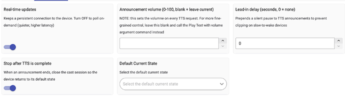

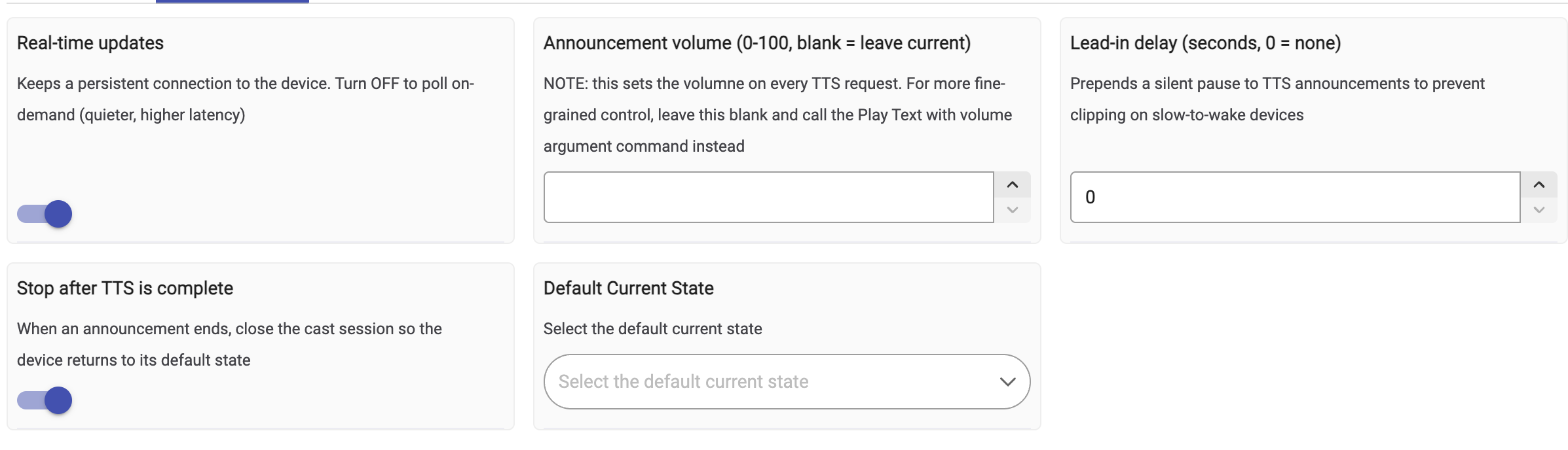

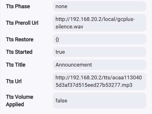

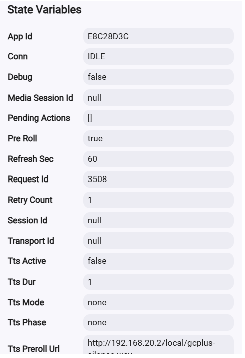

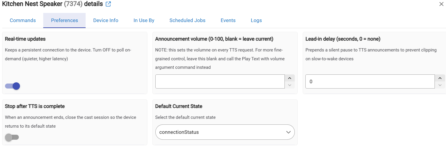

I pushed a new version 1.0.6 with the following changes:
  • remove the app level silence settings and replaced them with a driver level lead-in silence setting. It's defaulted to 0/off so make sure to set it for any device that has this clipping issue
  • refactor how silence is added to TTS.. before app would play a silence .wav file and then play the original TTS .mp3; Now it uses SSML when generating the TTS mp3 file to add the silence to the generated mp3 -- no separate silence wav file needed
  • added a new driver option 'stop after TTS is complete'; this matches what the built-in driver does too -- if checked, every play TTS will have that initial beep message vs today the first one typically will but subsequent messages right after won't
I still have 1 more idea up my sleeve but want to get feedback on this first..
Works like a charm! I added a 1 sec delay to the Nest Hub and the TTS worked correctly. Did not need to add a delay to the Nest mini speakers.
Thanks for sticking with this and developing a solution. Much appreciated.
Looks like that (1.0.6) has done it for me with the Nest Hub Max. :partying_face:
I set a delay of 1 second and it’s cleanly playing the text with and without a volume change. I also enabled the option to stop after playing the announcement.
Really appreciate you sticking with us and figuring this out. Now I need to update my rules and such to use this integration.

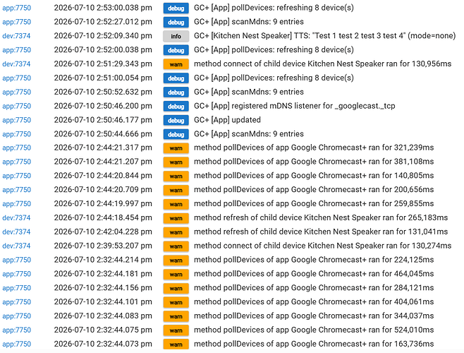

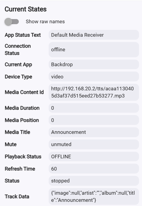

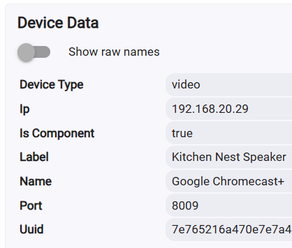

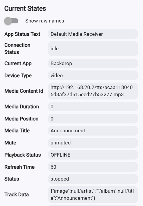

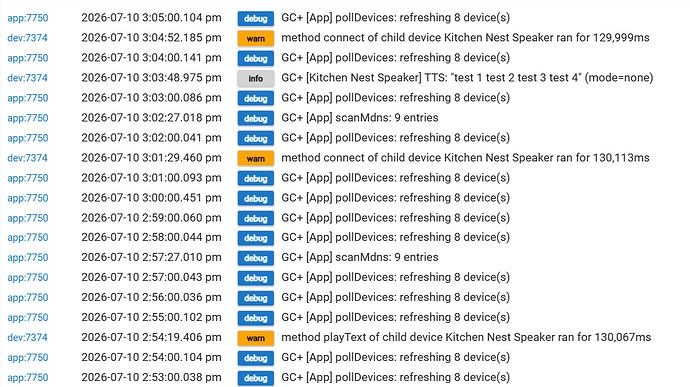

In case this is still useful/relevant. Nest Speaker went into the "Offline" state, so I'm able to do above tests. Play text fails at this point.
Device info:
Logs:
Ping failing in this case (I've previously seen "Offline" state in Chromecast integrations but the speaker was still pingable. Not sure if that had ever been the case in this chromecast integration.
Initialize command in driver brought Connection Status back to Idle. However Playback Status is still Offline, and Play Text still fails.
Connection status returned to Offline just after added the last couple of screen caps above.
To be clear, I think my Nest hub Offline issues are device (and maybe network) specific), not related to this integration. Never used to go offline, but likely some "upgrade" from Google messed things up for me at some point. My Google Home OG and Google Home Mini do not go offline.

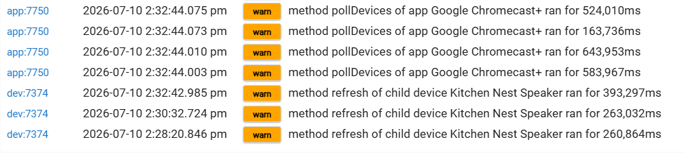

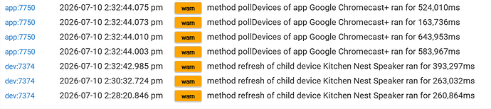

Summarizing what AI got out of the logs... when the Hub tries to connect to that device the connection hangs and blocks any other connection made after it. That 130 second timeout isn't something we can control or reduce.
Calling initialize doesn't actually fix anything - just sets the state to Init (which will force it to re-connect but nothing can really happen until that first connection times-out)
  Root cause — a blocking TLS connect. Every method … ran for 130,xxx ms warning is interfaces.rawSocket.connect(…secureSocket:true…)
  blocking. Hubitat's rawSocket connect is synchronous with no connect-timeout option, and a device that drops SYN packets (powered but
  flaky — exactly what "ping fails but it's not fully dead" looks like) takes the full OS TCP timeout, ~130s, to fail. So:
  1. The app poll stalls for minutes. pollDevices calls each child's refresh() serially on one thread, and refresh() called connect()
  inline. One stuck device blocks the whole poll and every device behind it — that's your pollDevices … ran for 524,010 ms (≈4 stacked
  130s connects in a single cycle), plus all the overlapping poll warnings.
  2. User commands hang 130s then fail. playText/speak → announce → enqueue → pump (state IDLE) → connect() inline → 130s block →
  action dropped. That's playText … ran for 130,067 ms, and it re-paid the 130s on every retry because the offline guard was only in
  refresh(), not the command path.
  3. Initialize only half-recovered. It reset state.conn/connectionStatus but never cleared playbackStatus (left at OFFLINE by
  markOffline) — exactly the reporter's "Connection Status = Idle but Playback Status = Offline." And since the device was genuinely
  unreachable, the connect Initialize schedules 2s later blocked 130s and re-marked it offline ("Play Text still fails / went back to
  Offline just after"). Initialize can't revive a truly-unreachable device.
  What this does and doesn't fix
  - Fixes: the 130s stalls on the app poll and on user commands, the cascading poll pile-up, and Initialize's misleading half-reset.
  - Can't fix (platform limits): we can't shorten the ~130s connect (no timeout knob in rawSocket), and nothing can make TTS play to a
  device that's actually unreachable. Recovery still relies on the 300s markOffline retry reconnecting once the device comes back — but
  that retry no longer hurts anything now that it's off the foreground threads.
It did make 1 change which was to prevent blocking other devices when 1 device is stuck like this.
If you have any other ideas of things that could help to un-stick it let me know.. only thing that comes to mind is a reboot but I'm guessing you've tried that many times before too

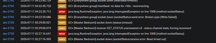

Query. Is this a normal day in the logs for a device or are things still being tuned?
I have a lot of Google CC stuff but mainly subscribe to 3 groups and one speaker for HE use.
These are logs today from one Mini and one group, of mixed devices, that covers the house.

According to AI this is normal/expected behavior.
  Verdict: not a functional problem — the driver is recovering exactly as designed
  Every line in that screenshot is the reconnect machinery doing its job. Read bottom-up, each device shows the same healthy sequence:
  socket drops → driver notices → driver reconnects. The two devices are also hours apart (Master Bedroom ~02:27, Everywhere group
  ~04:22), so this is occasional idle-drop churn, not a tight loop.
  Master Bedroom (dev:2735)
  1. 02:27:16.593 warn — socket down (socketStatus:receive error: Read timed out) — Hubitat's raw-socket layer reported the read timed
  out; socketStatus() caught it and tore the socket down. Correct.
  2. 02:27:16.641 error — InterruptedException … (method socketStatus) — 48 ms later. This is platform noise (see below).
  3. 02:29:00 warn — GET_STATUS unanswered x3 … forcing reconnect + socket down (status-timeout) — the reconnected socket went stale (a
  "zombie" connection — TCP alive, but the receiver stopped answering polls). The zombie watchdog counted 3 missed polls and forced a
  clean reconnect. This watchdog exists precisely for this case — working as intended.
  Everywhere group (dev:2742)
  1. 04:22:20.686 warn — socket down (socketStatus:send error: Broken pipe (Write failed)) — the far end had already closed; our next
  write failed. Caught, torn down. Correct.
  2. 04:22:20.712 error — InterruptedException … (method socketStatus) — platform noise again.
  3. 04:22:45.723 warn — heartbeat: no data for >35s - reconnecting + socket down (heartbeat-timeout) — the 35 s watchdog backstop
  firing. Correct.
  Groups ("Everywhere group") and idle Cast devices routinely drop their 8009 sockets — this is normal Cast behavior, not something the
  driver caused.
  The one thing that's ugly: the error-level InterruptedException
  This is the only line that looks alarming, and it's essentially cosmetic. When the socket dies, Hubitat interrupts the thread blocked
  in the socket read/write; that interrupt surfaces as RuntimeException: InterruptedException and gets attributed to socketStatus (the
  socket callback on the stack). It's a side effect of the teardown, logged at ERROR by the platform's uncaught-exception handler — it
  does not stop the reconnect (you can see recovery proceed right after it every time).
I'll lower the logging on the error and warnings to debug so you'll only see them if debug is enabled on the app.

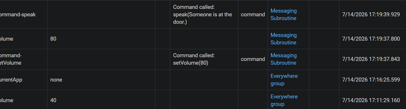

Just starting to test he new integration.

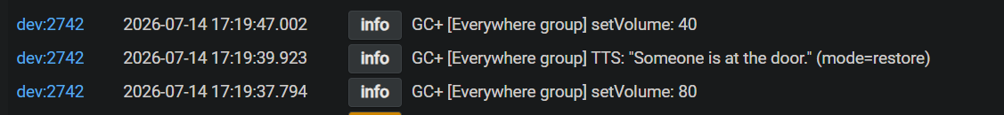

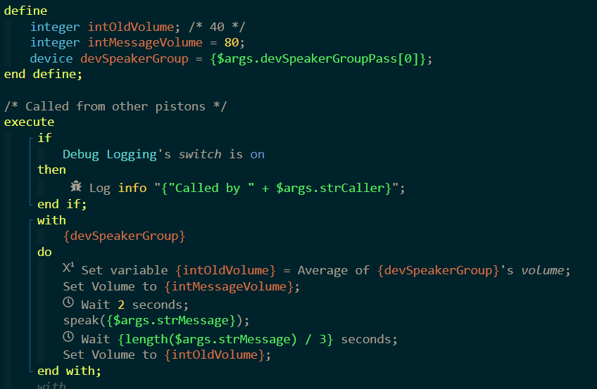

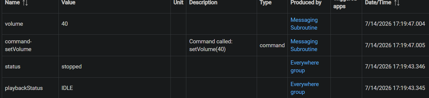

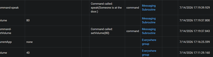

First thing I notice, from a WebCore perspective, is that setVolume doesn’t seem to work with Groups.
I have a 2 second delay for setVolume to ‘set’ before the speak.
Events shows the action but I hear no volume difference.
Finished and returning old volume:
messaging piston
I tried it with a single mini and it works.
I tried it with 2 different groups and it sets the volume to 80 but fails to say anything.
I tried a leading delay of 2 sec, nada.
Where to test from here? Re-install? I’m on the latest build 1.07.

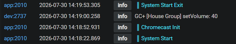

Here a non-issue. :slight_smile:
Every time I boot I get a random number of info log entries for each device/group.
Last time I booted I got 3/4, this time 1/4.
I don’t see where you can turn on/off logs so not sure where the randomised log entry comes from.
