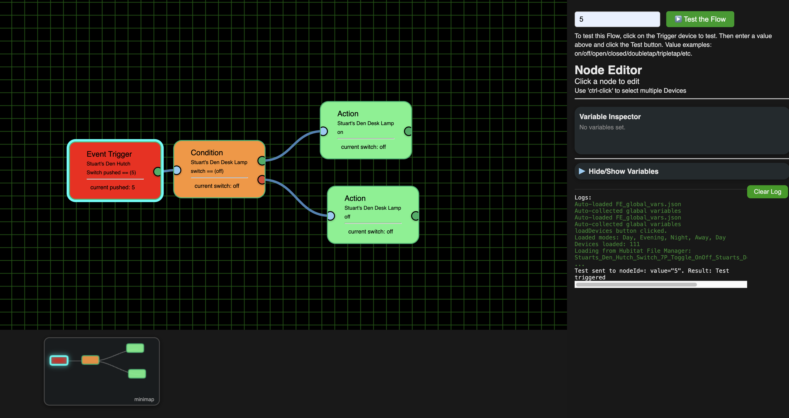

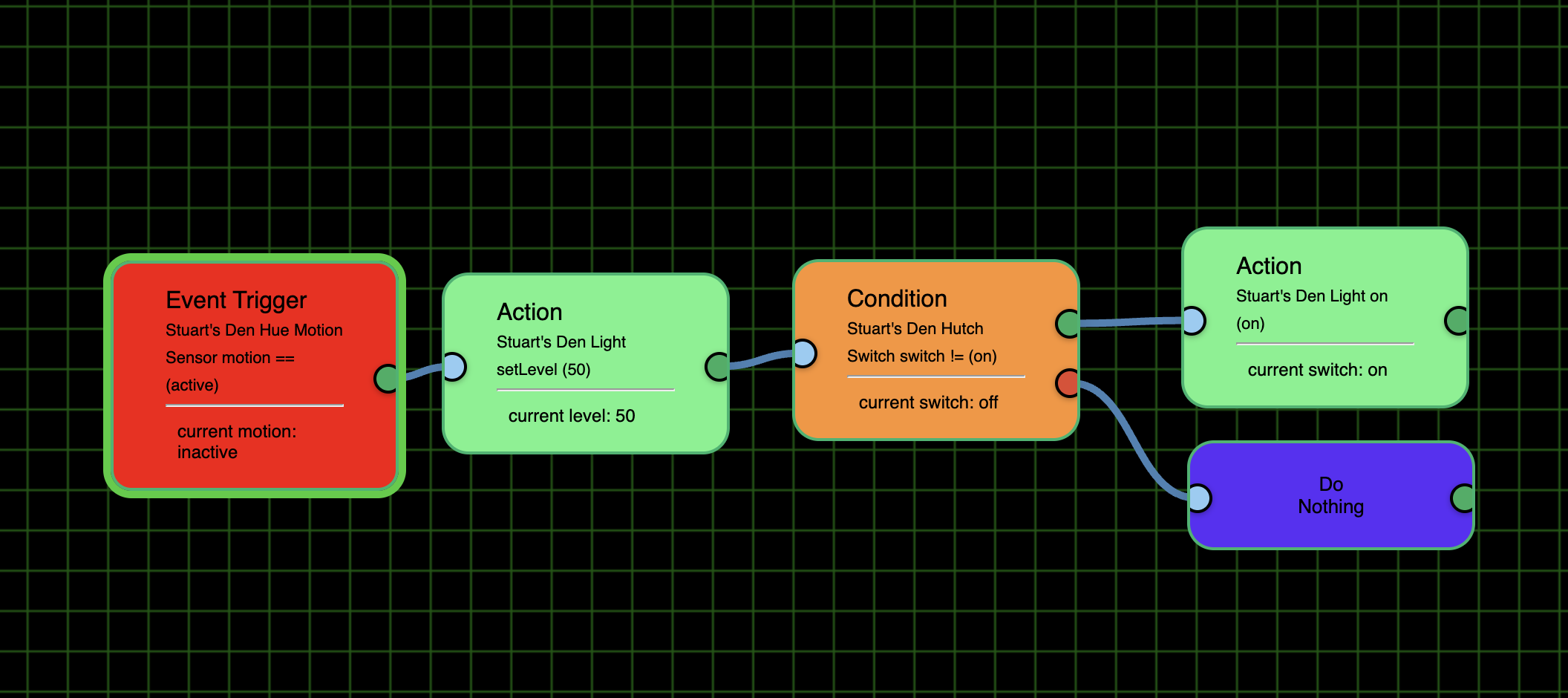

I don't know why, but the flow isn't visible for me when I do a Test Flow. You can see from the screenshot the Trigger is selected in both the main area and minimap. Plus, you can see I put in the value of "5" for the test which is what should have resulted in a True flow path.
When I pushed the Inovelli button 5 times the flow appears and it worked. (The switch is an Inovelli red dimmer, LZW31-SN and the flow is showing that it was not == off (i.e. it was on) and thus it was turned off (which is why the Condition box is now showing it is off.)
BTW, is there a way to make the flow more visible. Sometimes I really have to strain to see it as the flow outline is just a fuzzy yellow.

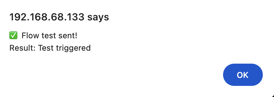

To WarlockWeary's question about the different connector colors, am I correct that they start off blue and turn green if that is the flow path? If that is correct, then the fact that all of my connectors are still blue in my first screenshot shows the flow wasn't tested when done from the Test the flow button (even though I got the pop-up saying it was tested - and I am doing all for this on my Mac Mini M4 Pro in a Chrome browser).

Blue is the default color, Green is the Flow running, tracing the path taken.
The Test feature is only setup to handle up to 3 taps, I'll have to edit it later.

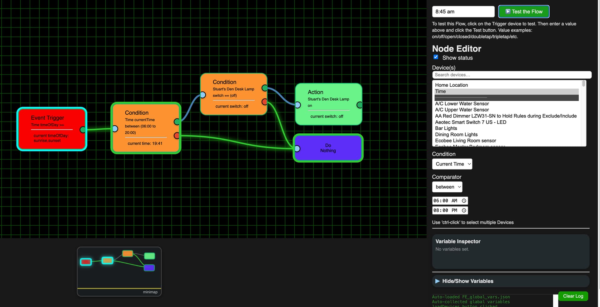

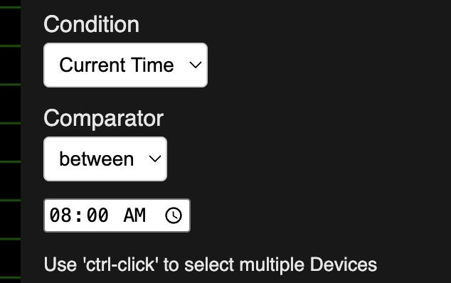

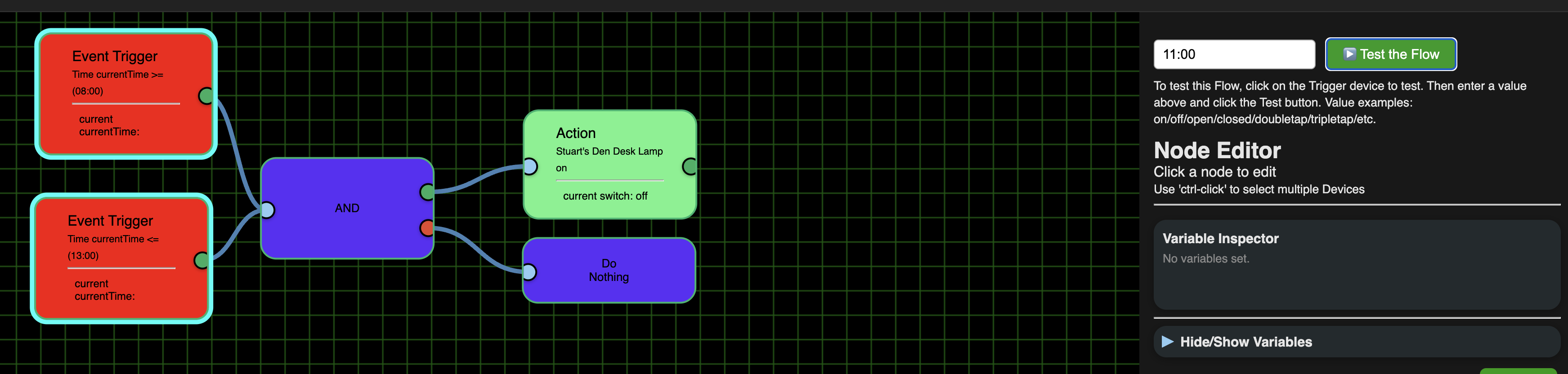

I wanted to test a Trigger for between 2 times. However, the 2nd time box never appears:
Screenshot 2025-07-02 at 11.36.21 AM

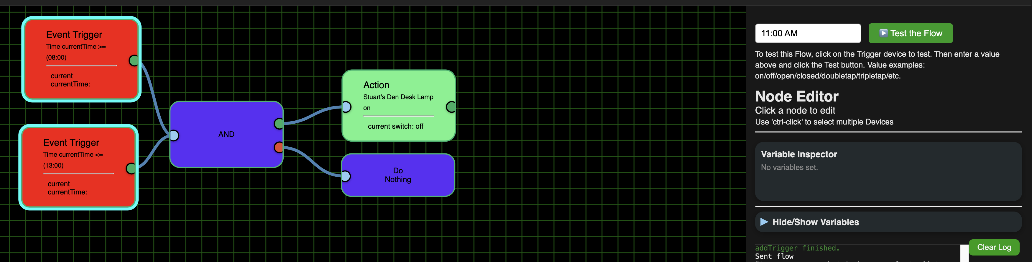

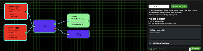

I also tried to do a time test with an AND >= 8:00 AM and <= 1:00 PM (13:00) by putting in 11:00 AM and then tested it with just 11:00. The test never ran. BTW, I did these tests at 11:46 and 11 :47 am
Also note the current time does not appear below the line in either Event Trigger. I would expect that it would just like a switch or light reports its current state below the line

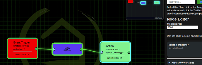

Not sure the delay-MS tab is not working .. set it to 5000 < turn on/off right away.
I'm baaaaack!
  • Current time now shows on triggers/conditions
  • Between now shows the time inputs correctly
  • delayMs now works
'Repair'

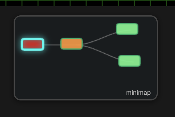

  • Better highlighting on the mini map
'repair'

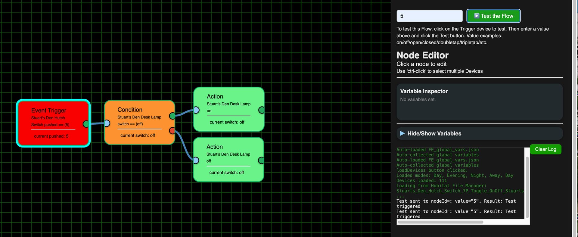

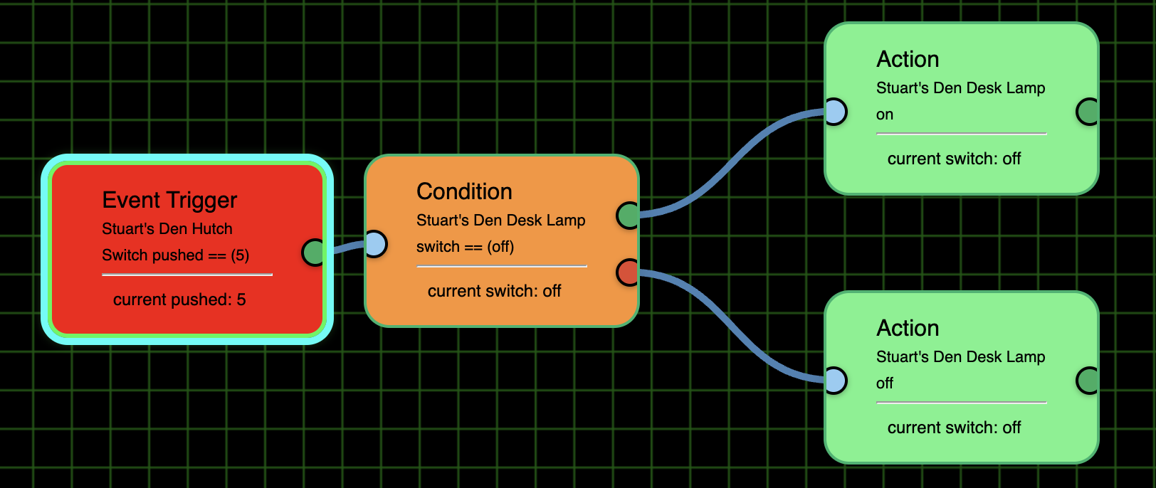

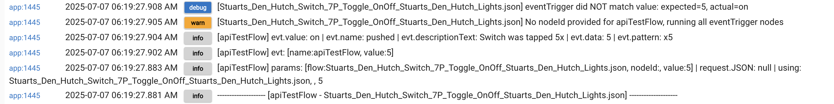

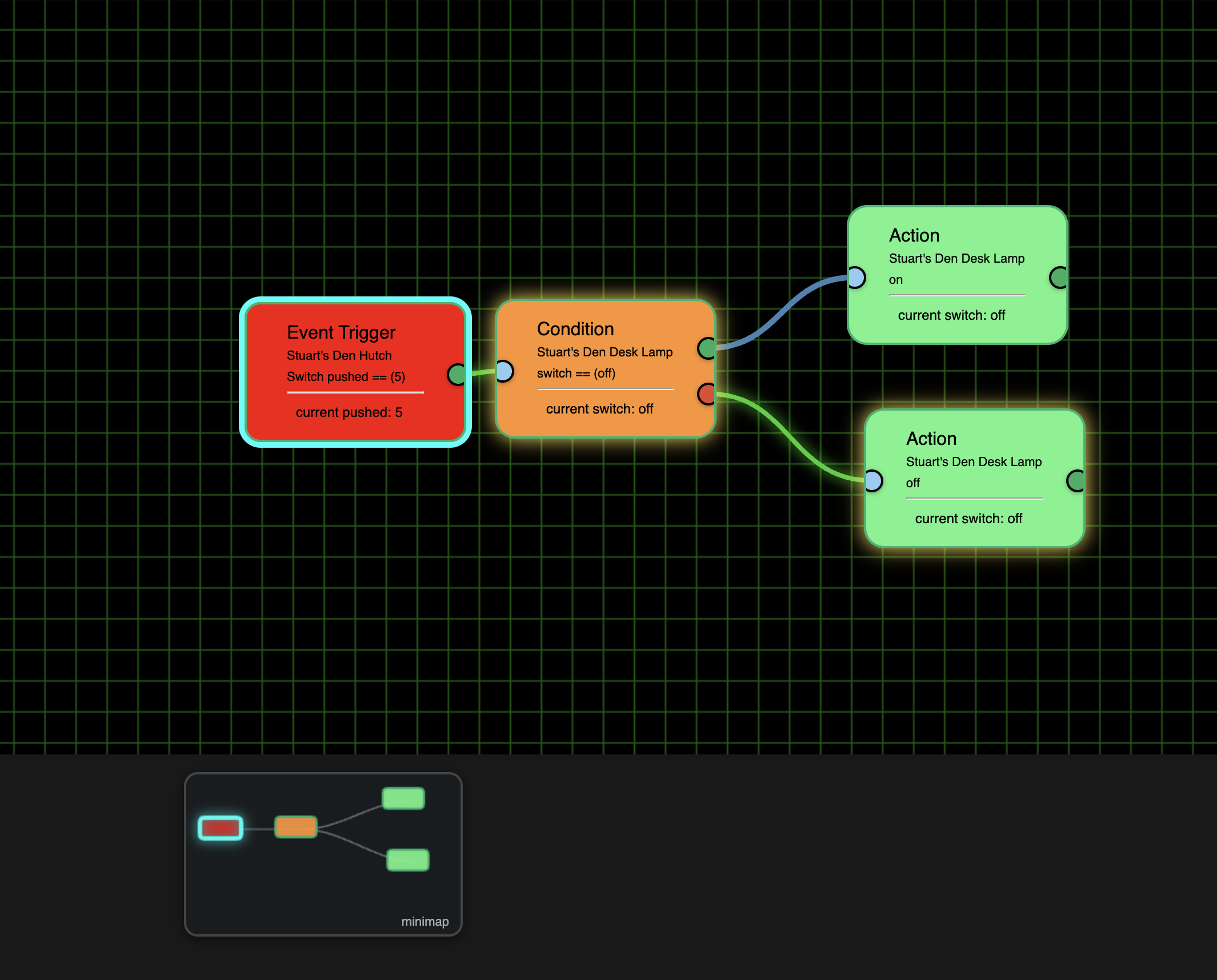

I tried to test the Inovelli Switch again, but it didn't run. Here is a screenshot showing the Trigger was selected and value 5 was used.

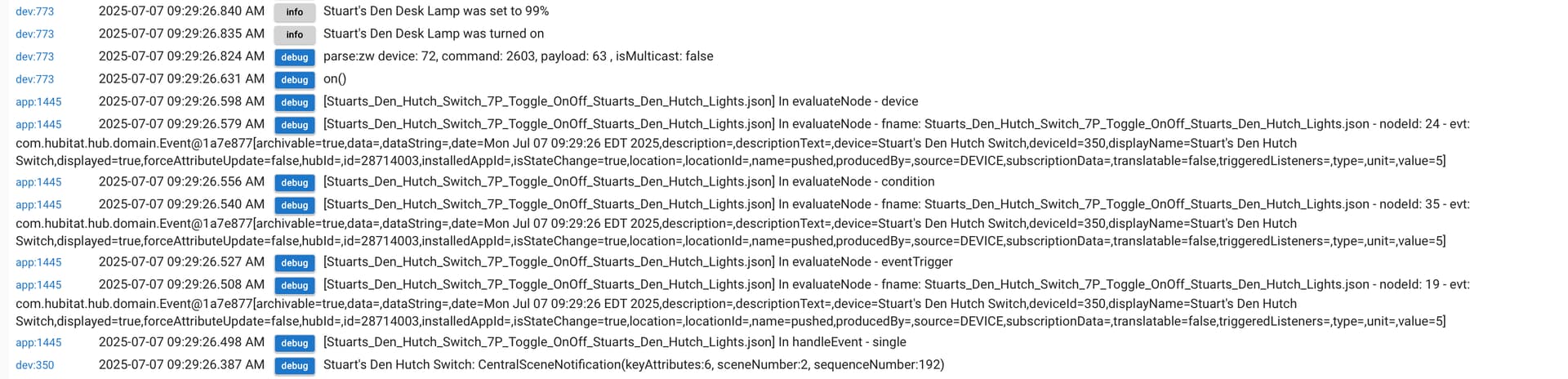

Here is a screenshot of the logs showing that it expected a "5" but what it got was "on"
BTW, here is what the logs look like when I click the physical switch 5 times:

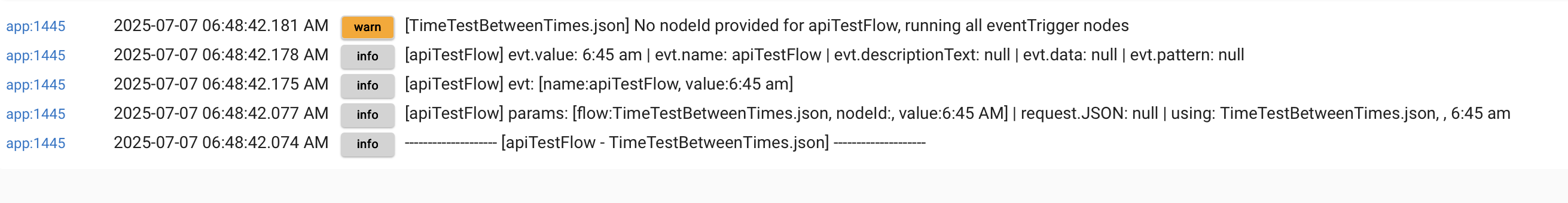

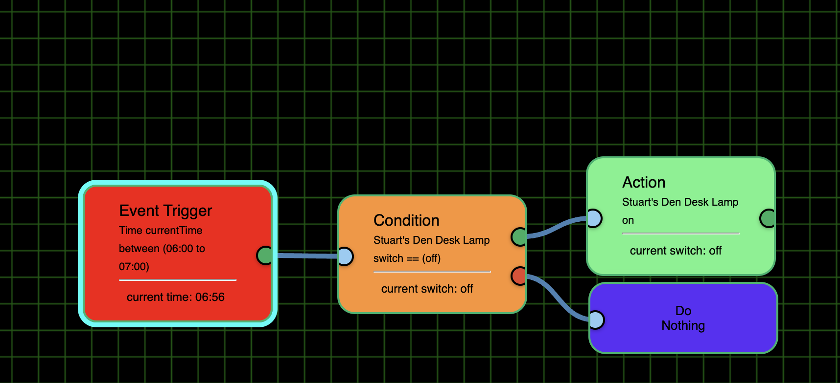

I also created a new flow to test the between times condition. I found that I had to save the flow, close it, go to the first FE1 window, activate the flow, then go back into the Flow Editor and pick it before I was able to test it.
My test was that if it was between 6:00 AM and 7:00 AM to turn Stuart's Den Desk Lamp On if it was off. As I did this at about 6:43 AM it should have just turned on by itself, but it didn't.

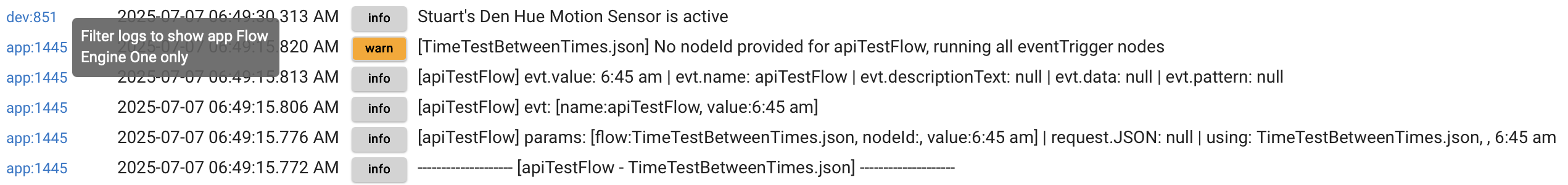

I then tried to test the flow using 06:45 AM, 06:45, 6:45 AM, and 6:45 but none of them ran the flow either. In looking at the logs it seems the time was being converted from "AM" to "am":
So I tried putting in the test time as "am" but that didn't help.
I went back to the flow to see if I could enter the comparison times as "am/pm" but couldn't. So I think it may be failing as the AM/PM isn't matching the "am/pm" part.
Here is a screenshot of the flow:

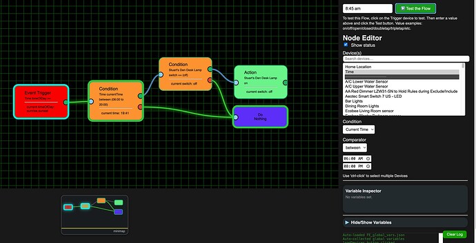

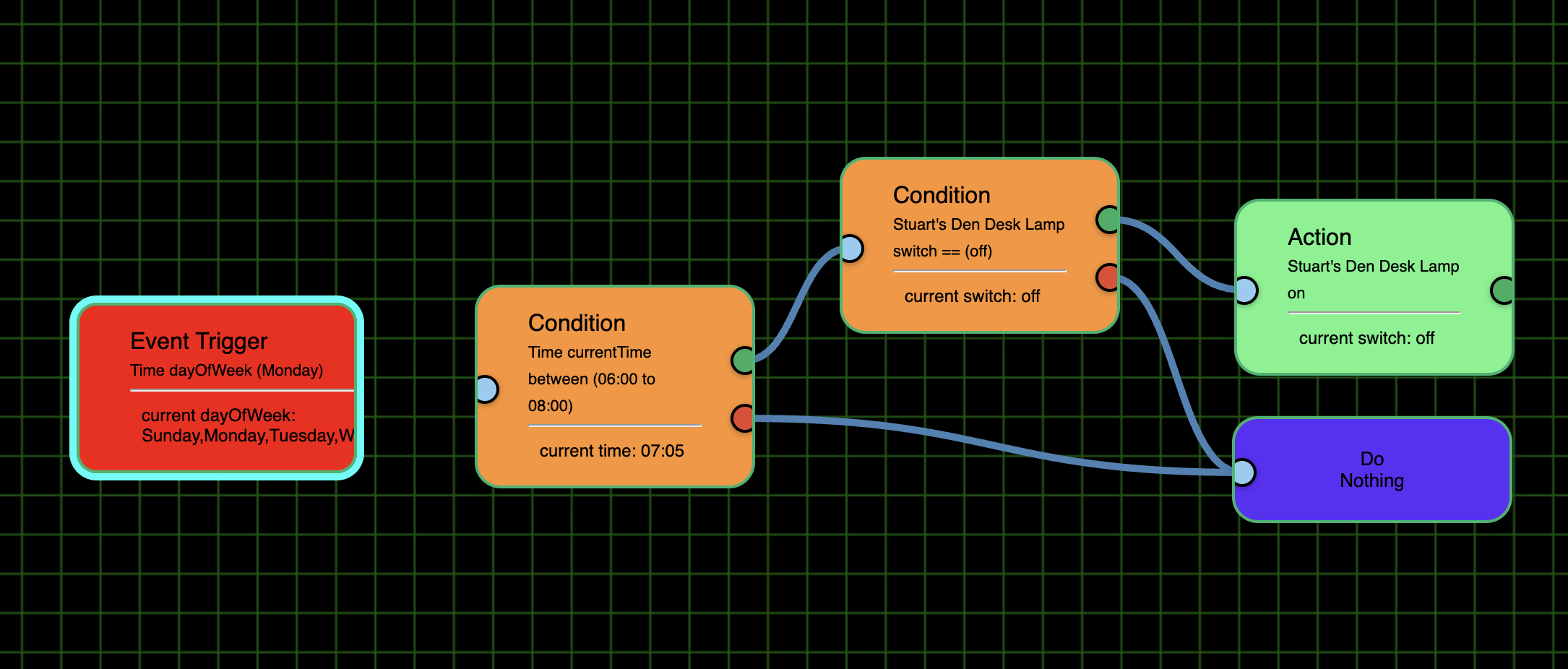

I then thought I'd do a test where the time comparison was the Condition, not the Trigger. For the trigger I picked that the Day of the Week was Monday. However, that was no exit point from the DOW.

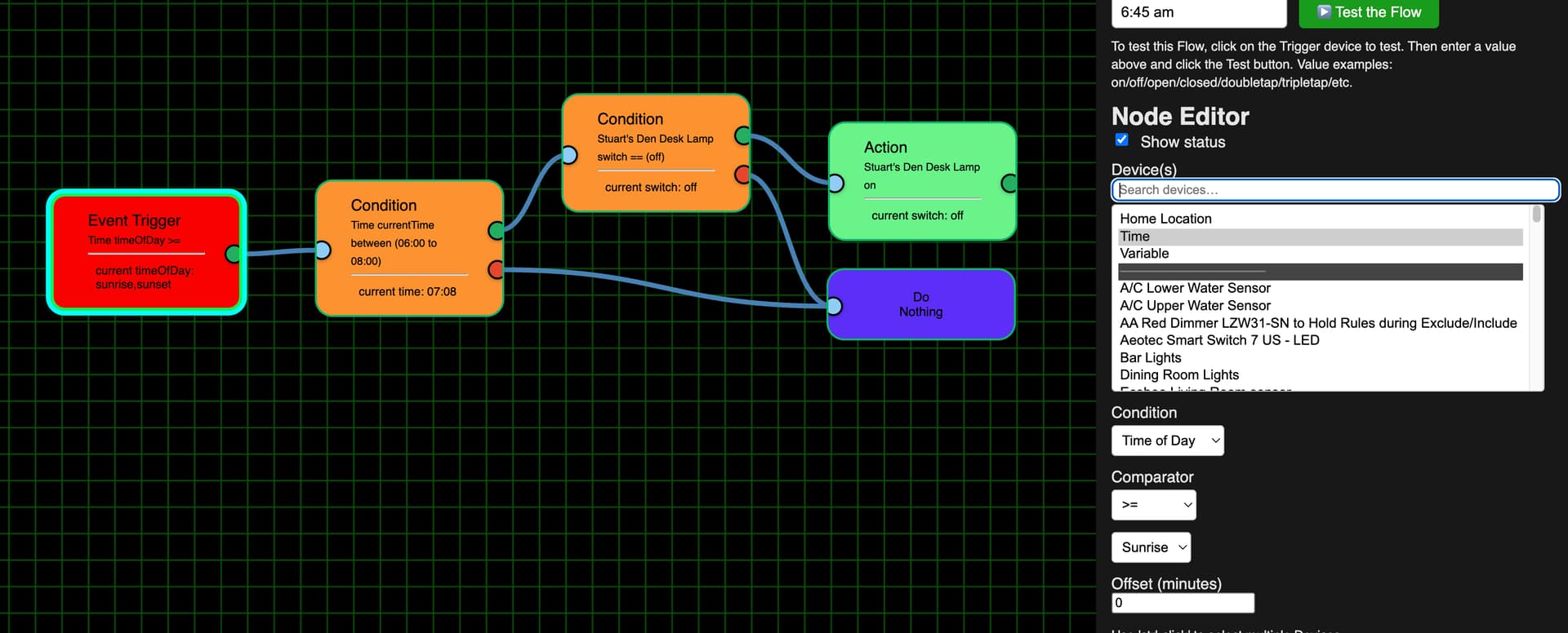

I then tried to make the Condition that it was >= Sunrise. While there was a connector this time from the Trigger, the actual condition >= was missing the Sunrise portion:

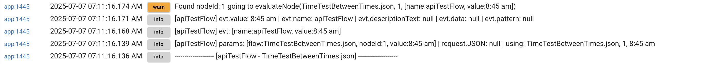

I tried to test this with 8:45 AM, which I know is after Sunrise, but that didn't trigger the flow. Here are the logs for that test:

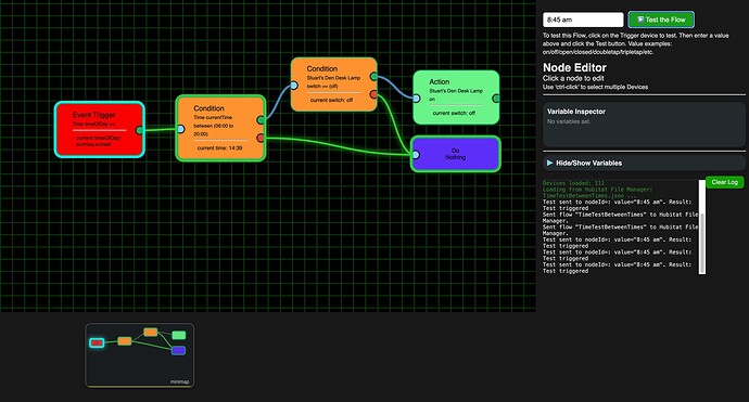

On the chance you have been working on FE, and maybe even have done a repair, but didn't post it yet, I went and did a repair about 2:35 pm Monday. It looks like my hunch was right because I was able to see that a time based flow was evaluated and the flow appeared in the mini map as well.
However, "Sunrise" is still not appearing in the Event Trigger tiles and it did not evaluate it correctly as my test time, 8:45 am, is >= Sunrise.
Here is the logs it produced:
As you hadn't posted for us to do a repair, of course, this was just on my own and I'm sure you felt you weren't ready to do a new "repair" post. As such, I don't know if you have worked on the Event Trigger Sunrise/Sunset yet and/or evaluating >=Sunrise vs. a time, I'm just posting this in case you have to let you know there is still issues with it and to let you know that at least it is running and that the mini map is showing the flow nicely too. So I hope you take this as me just trying to help the process by doing lots of testing and not criticizing you in the least. If anything, I hope you understand that by me doing so much testing (even when you hadn't posted to do new repair) that it shows how excited and enthusiastic I am about all you are doing. As I've mentioned before (too many times now? :-)) I really think this could go a gigantic way to silencing any critics who say they love Hubitat's power, price, and features, but find the rules UI cumbersome. So please take this as my enthusiasm and not negative meddling.

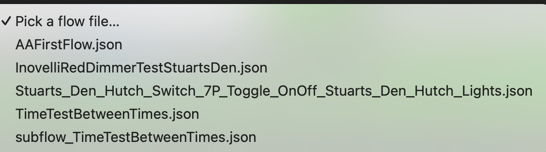

I did a repair and then went into the FE1 initial screen, hit done (which took me out to the Apps level), went back in and then went into the Editor.

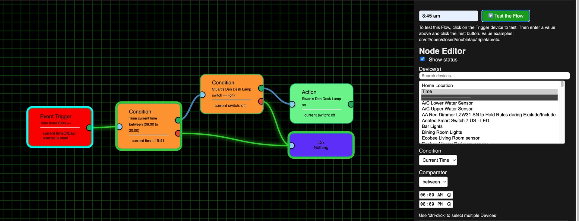

I saw that my time comparison one created a sub flow.

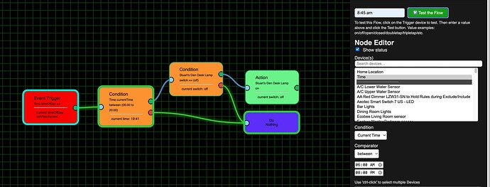

I tried them both using 8:45 am and they both failed. It also didn't fire off by itself as the time when I tested it (19:44 (i.e. 7:44 pm) is >= Sunrise and is before 8:00 pm.
The top one is the sub-flow and the 2nd one is the one I created.
BTW, I don't think the False choice coming off the 2nd condition (was Stuart's Den Desk Lamp On) should have fired as that condition wasn't on the path (although it should have been on the path as it is after Sunrise and before 8:00 pm. But if it had been properly on the path then the top/True choice should have been selected as the Desk Lamp is off. I'm guessing the 2nd condition (incorrectly) got fed a False so the False choice was selected coming out of it).

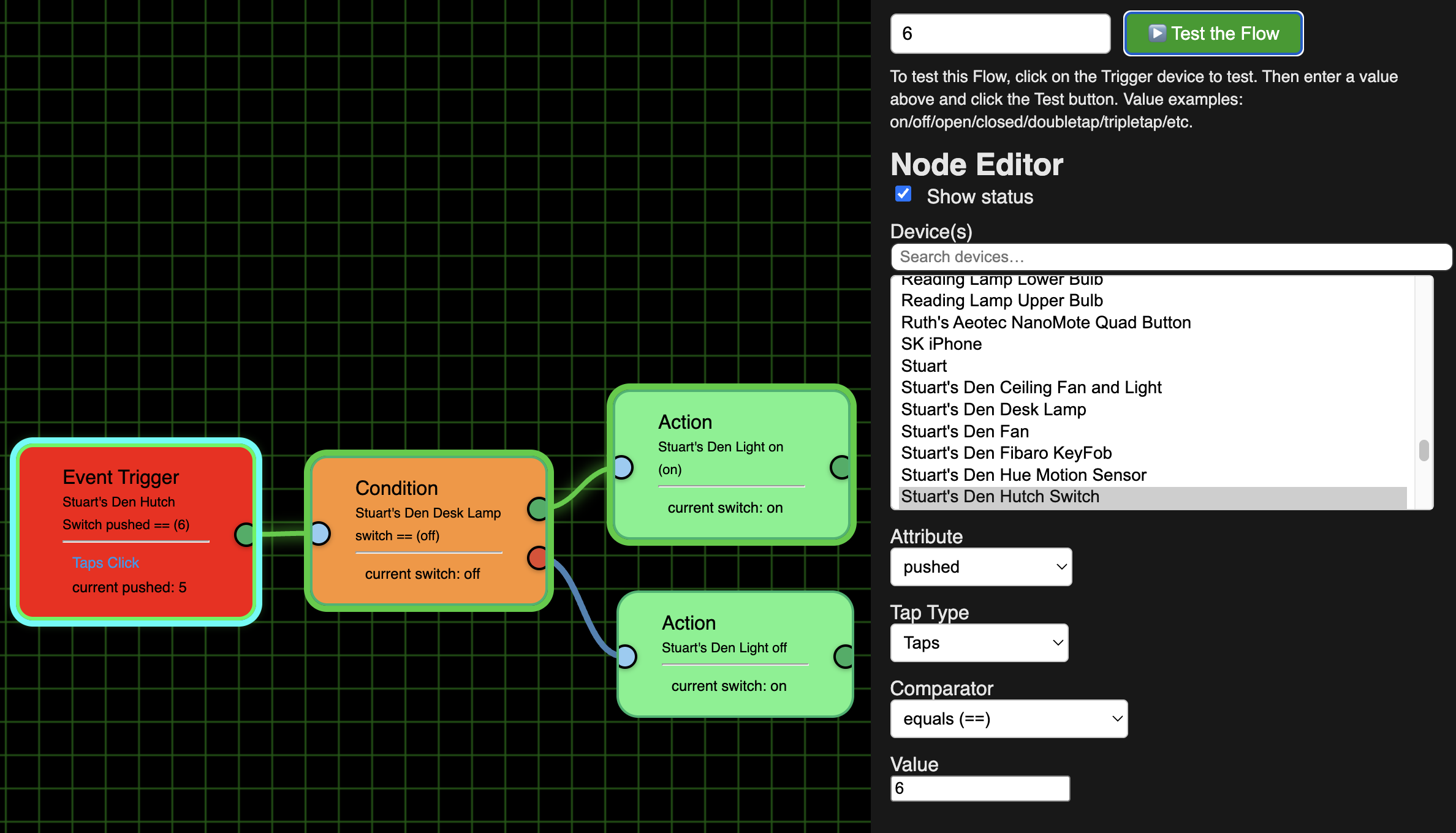

The switch taps has now passed the test:
(Though I found the neon blue Taps Choice a bit hard to read).
Also, BTW, I thought my eyes might be deceiving me, but I'm now 99.9% convinced the tiles jiggle every so often. The least of all issues, but don't know if that can be prevented.
