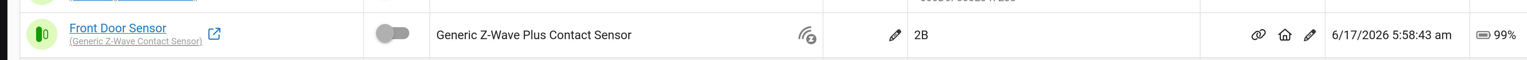

As you can see from the following screenshot, the device list page shows that the device called “GarageDoor West Sensor” has an icon of a Home on it, indicating that it is HomeKit enabled.

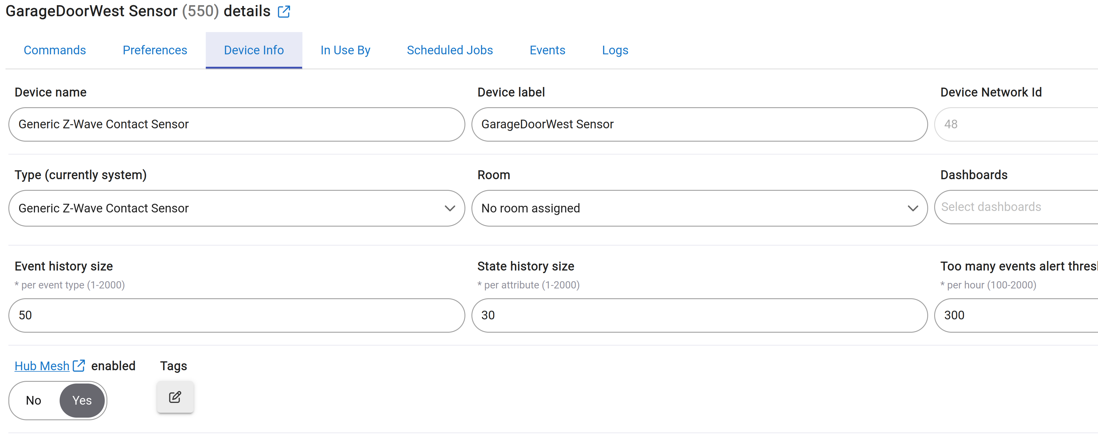

I don’t have HomeKit integration on this hub at all, and it is not HomeKit enabled - it’s a simple zwave tilt contact sensor (as per the screenshot below of the device info page).
This is not a serious bug, but it is a strange one.
device info page:
P.S. I have just noticed that I’ve got another one:
Again, this is a zwave contact sensor on my front door. As described above, there is no HomeKit integration on this hub.
where do you see homeKit?, i see a zwave device with hub mesh enabled…
The Home Icon on the device list page, indicates that the device is enabled for HomeKit.

No. It should only show the home icon if the device is enabled for HomeKit. That's how it appears on my C8 Pro.
Again, I do not have HomeKit enabled on this device.
In fact, I do not have HomeKit at all on this hub.
I believe that this is a small bug, because it’s only the icon on the device list page, that is incorrect (in this case).
