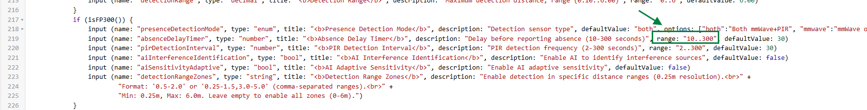

The absence delay timer setting has a minimum of 10 seconds. The documentation suggests that the minimum might be lower. It gives an example of the total time of 15 seconds, with only 5 seconds due to the driver setting. Is there any way to get the shutoff to be in the 5 seconds range?
-Tom
You can try experimenting by changing the minimum allowed value of absenceDelayTimer in the code from 10 seconds to 5 seconds :
Ten seconds is the minimum value allowed in the Zigbee2MQTT implementation. I’m not sure whether reducing it to 5 seconds would be stable, or if it might lead to frequent false “motion inactive” events.
