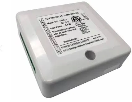

@a.visionaree In order to use a z-wave, zigbee, or dumb thermostat with your system, you need a Fujitsu UTY-TTRX or UTY-TTRXZ1 converter for EACH head. Once they're installed, you can install any thermostat. It will allow normal functionality. But for specialty things like adjusting the louvers you will still need the remote.

Have several of these, they’re a pain to connect up and configure, but I love being able to use any old zigbee thermostats to control the indoor units via Hubitat (of course any thermostat that can be integrated with Hubitat is an option regardless of how exactly it connects).

Personally, I think this is a much nicer solution. But the more expensive one. You get both local control of a device that looks normal, plus you can add a thermostat of your choice that integrates with Hubitat.

Yes, I will look into the converter solution since it's Fujitsu-built.

@user5411 you want to get the Fujitsu UTY-TTRXZ1 24V Thermostat Interface then use whatever thermostat you like. I recommend the Honeywell t6 z-wave pro thermostat.
