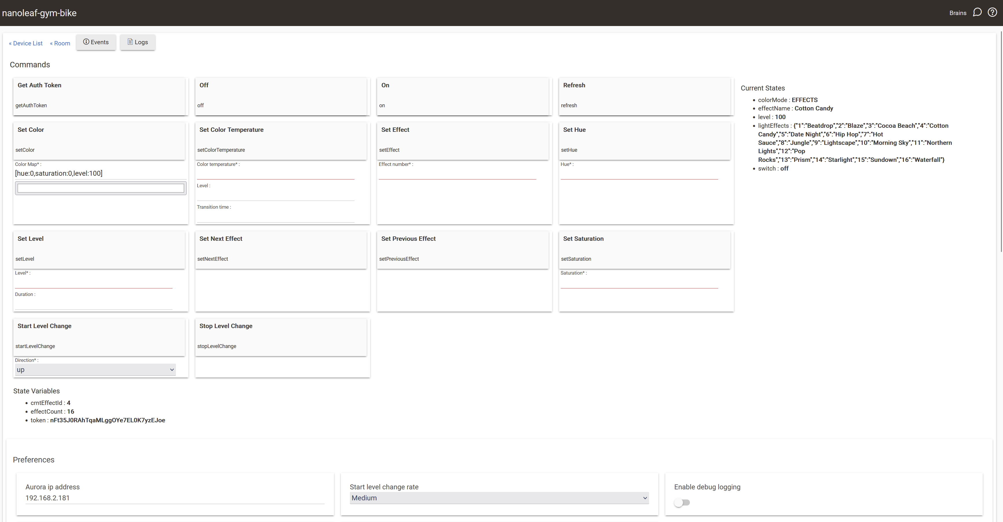

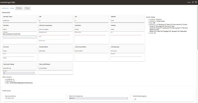

Can you explain how you have these integrated with hubitat? I just purchased the elements and was wondering how I might integrate and what the options might be? Is it just on/off or other control? Thanks!
Use the built in Nanoleaf aurora driver.
Step 1 Make DHCP reservation for element/aurora
Step 2 Create virtual device using built in nanoleaf aurora driver
Step 3 Input ip of nanoleaf on device page
Step 4 Go to device page. Press the physical power button on the elments control for 2 seconds then click the Get Authorization token button on device page. (you can optionally leave a live log page open to confirm it came through)
Step 5 enjoy controlling your nanolead lights from Hubitat.
Thanks!
