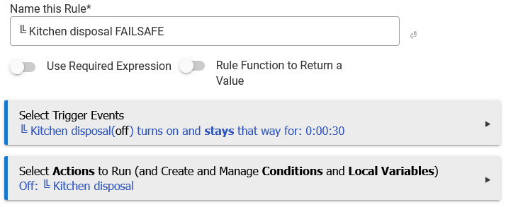

I always include the word FAILSAFE in the name of a rule like that, so I know at a glance what it does.
One of my examples:
