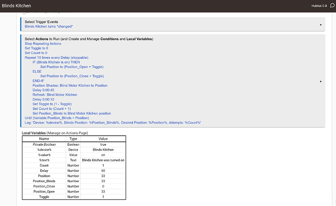

I had a similar issue with z-wave blinds. They would miss the command; however, Hubitat thought they were in the correct position. I wrote this rule which has not failed me yet. It makes 10 attempts at opening/closing the blinds according to a virtual switch on=open, off=closed. I can change the local variables for postion_open and postion_closed without changing the rule to meet my preferences. The rule changes the value of the positions by 1 degree (plus or minus) each time through the loop so that if the blinds motor or Hubitat thought thinks it is in the correct position, it will be forced to a new position and not ignore the request. The one degree is not noticeable. You may find a better solution, but this works for me.
