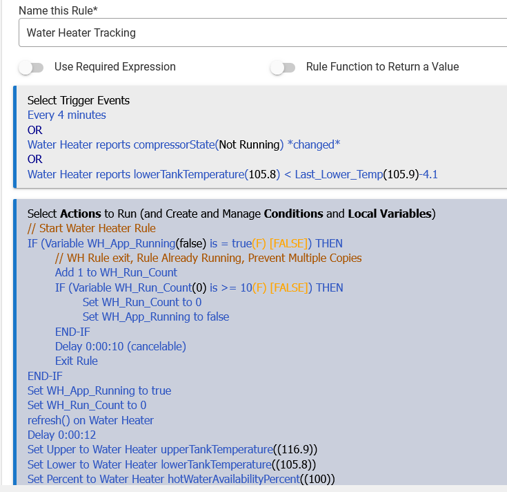

I have a rule app that has multiple triggers and may run for over a minute. I'm trying to avoid two copies of the same app running at the same time. At present, I check a global variable at the top of the rule, and exit the rule if marked running. If not running, I set the variable as running. At the very end of the rule, I mark the variable as not running.
This seems to work, but I'm afraid that if something blows up in the middle of my rule and the variable is left as running, the rule will never run again.

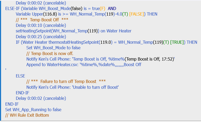

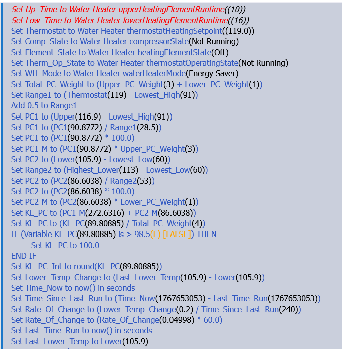

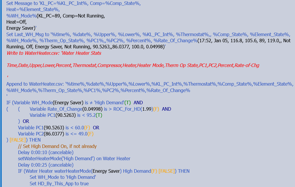

I really don't want to learn another computer language. I have a 130 line rule that is working just fine. It controls my water heater through various calculations and conditionals. It runs at least once every 4 minutes, but can run more often based on triggers caused by sudden changes in usage.
Use a global variable as a counter. Each time you exit due to the variable being set, increment the counter. If the counter reaches a set number, believe that the variable is stuck and reset it and clear the counter to zero. Always clear the counter when you go out the bottom successfully.

I would be happy to learn Webcore if someone got me started by volunteering to convert my water heater Rules app.
If want to post your rules, or even better, a description of how the rule needs to work, I would find some time to whip up a piston to demonstrate the differences.
It needs to do different things at different times based on a bunch of different data items. The rules show what needs to be done. It also logs everything to a file, and sends messages to my cell phone. The cell phone and log file are just being used for now so I can fine tune the parameters.
How do I post my rules?
Screenshots are really the only way to post rules, outside of writing up some pseudo-code that just shows the logic that is being done.

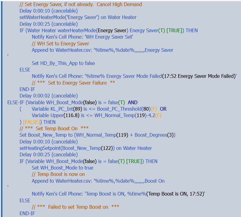

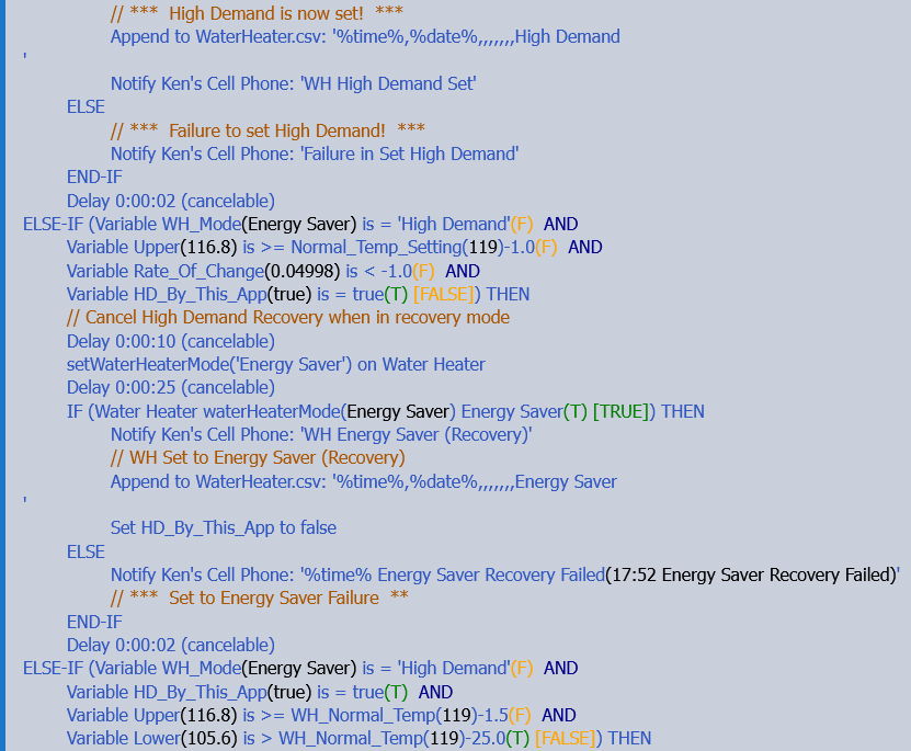

Ok, you asked for it. Please keep in mind that I never wrote a rule before a few weeks ago, so some things may not have been done as efficient as possible.

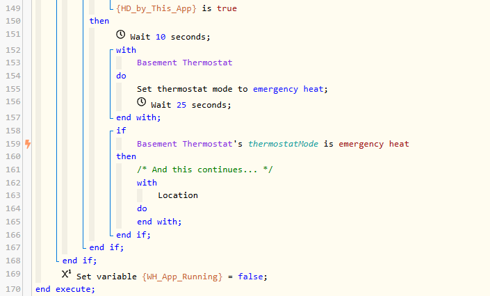

OK. There is a lot there, so rewriting all of it is a bit pointless. Here are some examples of how it would be done in Webcore. The real advantage is how you write the the piston, compared to RM rules.
A piston is just a container for some rules. It can have one rule or many, and pistons can call other pistons. A piston is a way to group rules together that make sense, and it is best to not do too much in one piston so it doesn't get cluttered and unmanageable.

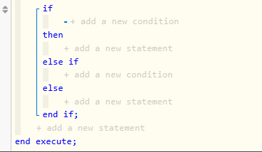

First, Webcore is dropdown selections and fields, just like RM. One nice thing is that your if statements are already formatted. You just fill in the sections, and you never have to close an if or else if manually.
The basics of Webcore are better looked up on the internet instead of me going into all that here.

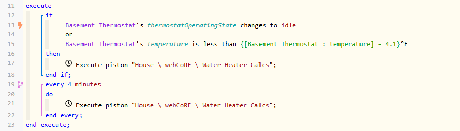

Like in your Rule, Webcore cannot combine timers and conditional checks together. So in this case I would make a trigger piston, that calls the calculation piston.
I used a thermostat where needed for demonstration, since I have no Water Heater device.
Here would be the trigger piston:
In this case, you do still need a boolean to check if the calcs are running, since your triggers can overlap. The case in Webcore you don't need that check is with things rising and falling over targets. In RM you want to trigger once when it falls below a target, you have to set a bool that it fell below, and that is where you can save a boolean with Webcore because Webcore accounts for that with the "falls below" or "rises above" conditions and it will only trigger once.

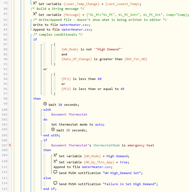

This is a limited version of your calcs in the called piston, just to demo things you are doing in RM.

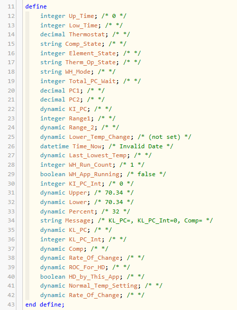

You have a LOT of variables. Those are declared at the top of a piston. You can declare a type, or just use Dynamic.
Yeah, not sure if this really reads much clearer than RM, but at least it uses indentation.
Not worth your time to rewrite this rule in Webcore for sure, but you could just try it out just to see how it actually works when building rules. You just follow the logic flow, and everything builds as it reads.
