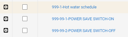

Hello jsut now getting to this
is this a good way to it ?

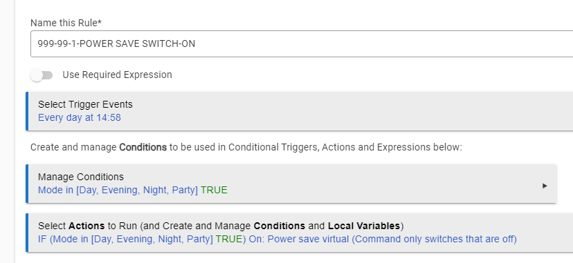

I see the second rule will turn on the virtual switch at 14:58
Not sure why you have the mode checks in there exactly?
I assume the Off rule is similar but with a different time.

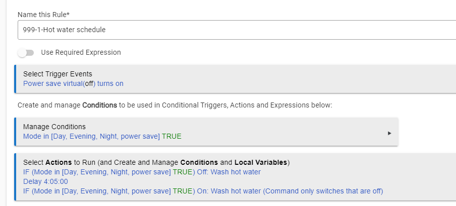

The hot water schedule rule looks like it will turn on the Wash hot water when the virtual switch gets turned on, and then off 4hrs and 5 minutes later. Having the Off (with delay) before the On command in the rule is a little confusing but should still work.
You might want to have the rule use a wait for events, and wait for the power save switch to turn off, and then turn the hot water off (instead of using a delay). Then it would follow your schedule exactly, instead of having a hard coded delay that would need to be adjusted if the saving period changes.
Again, not sure why all the mode checks unless you have some other mode like "Away" mode where you do not want it to run at all.
yes i have an away mode and dont want to auto turn on if we are away. ( the away turns off the hot water if the house is empty)
I will adjust the wash hot water to an event - makes more sense

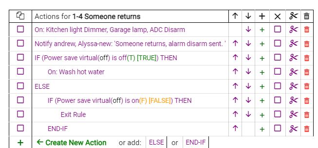

like this correct?
here is my home rule - i think i did this correctly - one day i will figure out how to make it cool and - have a sub rule like if away has been on more then 24 hours - turn on the hot water lol
edit whoops forgot to delete the first hot water on
If your "Power Save Virtual" is ON is then when your power saving time is active?
If that is correct then I think your rule is backwards, your rule will turn the hot water OFF when power save turns ON, and then turn the hot water ON when power save is over.
Otherwise the Wait for event part looks correct.
You also don't really need the Mode checks within the rule if you have it set as a conditional action, but also not hurting much either. Unless the mode changes while the rule is running, could possibly run the first action but not the second one if the mode changes to one outside of what's in your IF statement.
yes if power save IS on i want the HW OFF - so exit rule
if power save is OFF - HW want on (power save is from 3pm>7pm our electr rat fomr 3-7 is 30c kwh and all other times only 5c lol
Ok makes sense now, Power Save ON = power is more expensive so you want to turn things off (to save power).
