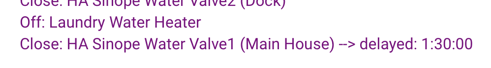

I'm currently using a common delay on my 'Close Water Valve' action but it has not worked so far.

What is not working? What does the log show?
Using a delay as you have is probably the best way to make sure it closes. Since you didn't make the delay cancelable then it should turn off the valve in 90 minutes no matter what.
Assuming the rule triggered and the line is executed. Showing a log of what happens once triggered would be helpful.
