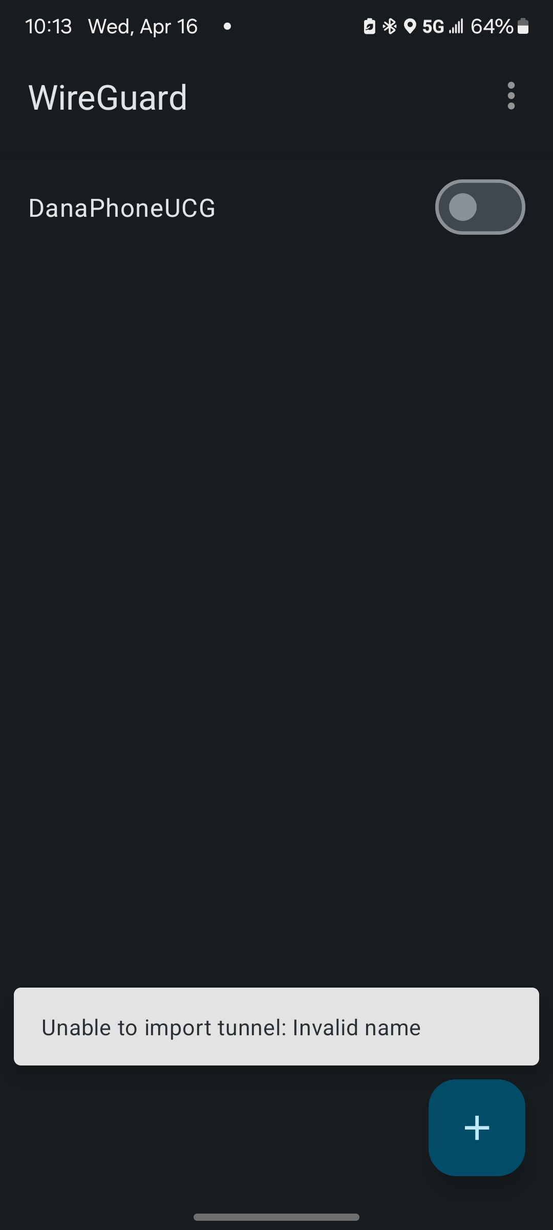

Thanks very much, I did have a dash in the name but no spaces. I'm going to try it again in a little while. I did try and import the conf file on my phone as well and it failed there too, so not just a issue with wife's phone
Trying a couple more times, removed any dashes from the name, and still not able to import our scan. I did get an actual error about an invalid name, but no helpful details, the name is just my wife's name with PH at the end of it no dashes so it's very bland.
Frustrating!
