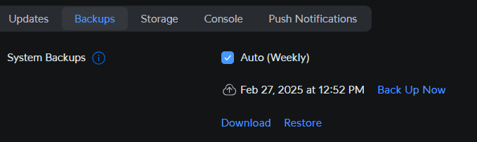

The backup probably should have worked. Atleast now you know it is connected and to your site manager. It may be a good idea to download a backup from youe ultra again just to make sure you have a good copy.

@mavrrick58 - thanks, good idea, I'll take/download another backup.

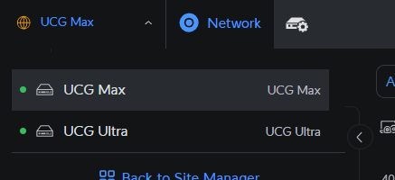

I ended up restoring a backup (.unifi backup file) downloaded to my laptop from the Ultra. Did it w/the Max connected via a switch to my Ultra network.
Let the backup restore completely and CG Max come back up and I ended up w/below (still connected to network via the Ultra). So both sites showed up and both sites had the same Network app settings/setup as desired:

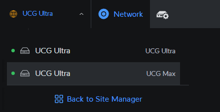

Both also had the same site name ("Ultra") so I renamed the Max site to UCG Max, (done in below in Settings>Control Plane>Console in case anyone's wondering), and then shut the Ultra, cable modem, and Max down, swapped in Max for Ultra, booted up cable modem, then when it was up booted up Max, and...

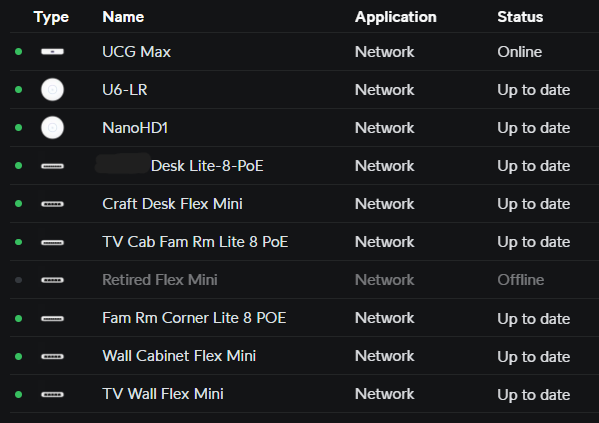

Everything got adopted over to the new UCG Max site w/out issue so far as I can tell (the "Retired" Flex Mini is intentionally offline). After a while I'll delete the UCG Ultra site, but for now keeping it around in case something goes south (either my mistake or some random early die-off of the Max).
