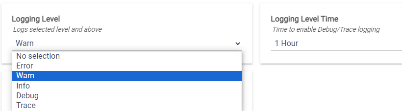

I felt this was odd as well, but had been copying the sample drivers so had it in all my drivers. I have since re-thought all of my logging and changed this log entry to an Info log on any of the more recently updated drivers. Not just simply changed it, but the logging setup was totally re-written. Has not made its way to my Zooz switch driver yet.
Gave it a proper log level drop down menu so you can even disable any warn logs if you are so inclined by selecting only error logging.
