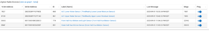

I only have a couple of Zigbee devices and I can't really say I noticed any difference on how fast they respond. Am I correct that there is no place to see Zigbee speeds in Hubitat?
You can look at rssi and lqi and extrapolate from that.

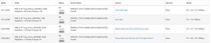

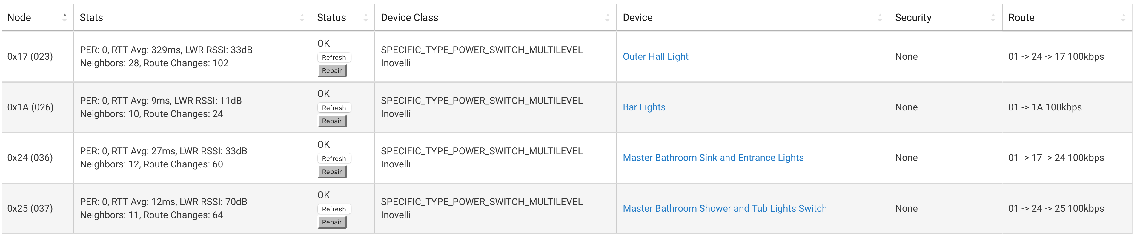

I'm not sure where the "lqi" is. Is that on the Zigbee page? Also, I'm not sure what the RSSI is and how it relates to the speed a device is communicating with the hub. Here is a screenshot of 4 devices that all say that are at 100 kbs, but have different RSSI numbers. Sorry to be such a noob, but could you please explain to me what this means.
BTW, I find it strange that the 1st one, 17, goes through 24, and 24 goes through 17. I would have thought that one of those 2 would go straight to the hub and the other through it. Not both using the other. But, is that just the Alice in Wonderland nature of Z-Wave (curiouser and curiouser)?
RSSI, or “Received Signal Strength Indicator,” is a measurement of how well your device can hear a signal from an access point or router. It's a value that is useful for determining if you have enough signal to get a good wireless connection.

You will see it for zigbee. If you want more on z-wave use the hubitat z-wave mesh details app... You get all this..

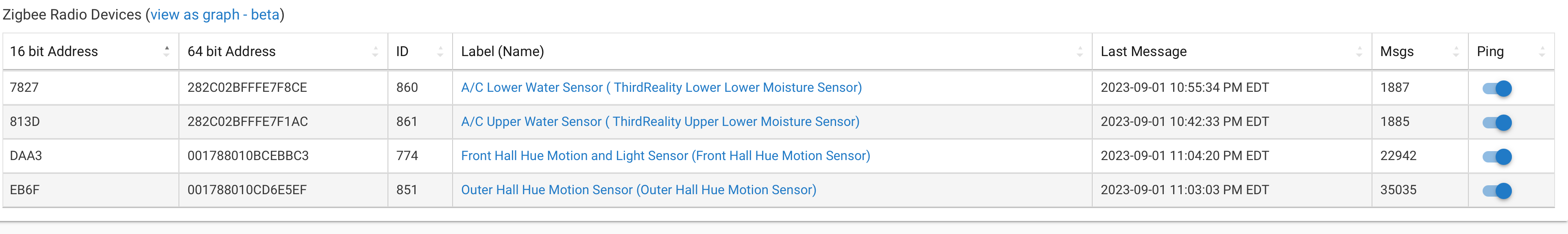

I know about the Z-Wave details page. That is where I was getting all the data from. But I still don't know where the lqi is listed. On my Zigbee details page it only shows this:
http://yourhubip/hub/zigbee/getChildAndRouteInfo
The link fails for me
You're not actually typing "yourhubip" are you? That's meant for the ip address of your hub. Put it in your web browser. For instance, this is what it looks like for me... http://192.168.2.122/hub/zigbee/getChildAndRouteInfo , you simply use the ip address of your own hub.
