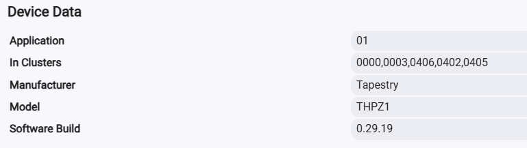

Has anybody had any luck with this presence sensor:
Tapestry Presence Sensor Z1
I'm currently trying the Hue Motion Sensor driver...
Thanks!

Is the Hue Motion Sensor driver working for this mmWave sensor?
You can also try other drivers mentioned here :
Thanks!
NYCE Motion Sensor Series seems to be the best choice here (reports motion, temperature and humidity), but Hue Motion Sensor also works (at least for motion).
Do you have another mmWave sensor to compare with the Tapestry sensor's performance?
@mike.maxwell may be interested in adding this sensor fingerprint to the right HE inbuilt driver.
I'm checking it against much-discussed Linptech right now.
By the way, NYCE Motion Sensor makes the Tapestry extremely chatty ![]()
Fortunately, Hue Motion Sensor works (albeit without humidity reading).
