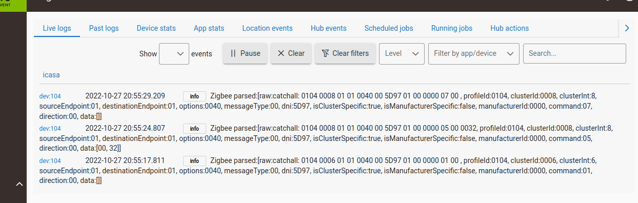

Thank you - this is the real fingerprint as composed by HE during the pairing process. I was close, but not 100% : )
Yes, the debug logs that you provided in a previous post are enough for decoding the button actions. Let's have the basic actions working first, then we will see if anything was missed.

Can you try this test branch :
https://raw.githubusercontent.com/kkossev/Hubitat/test/Drivers/Tuya%20TS004F/TS004F.groovy
Click on the 'Configure' button first, you should see ' * numberOfButtons : 8' on the top right 'Current States'.

You are welcome! Wouldn’t be possible without the detailed debug logs that your provided in your initial post.
