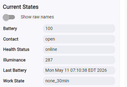

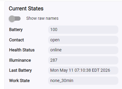

I am using exactly this driver but I don't see this Attribute:
Surprisingly I am seeing "illuminance"?
Is this a actually a "pressure" value?

OK, I performed an HPM Repair but this did not change a picture:
I am still seeing an “illuminance” attribute instead of “rawPressure”:
