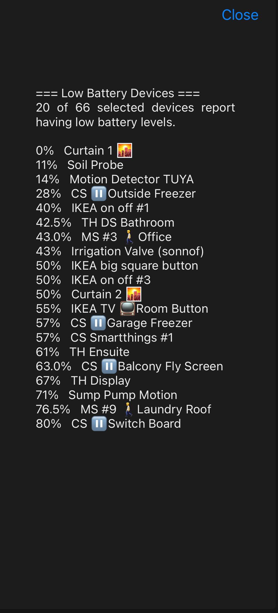

  • Plain-text table for notifications (e.g., Pushover, Hubitat)

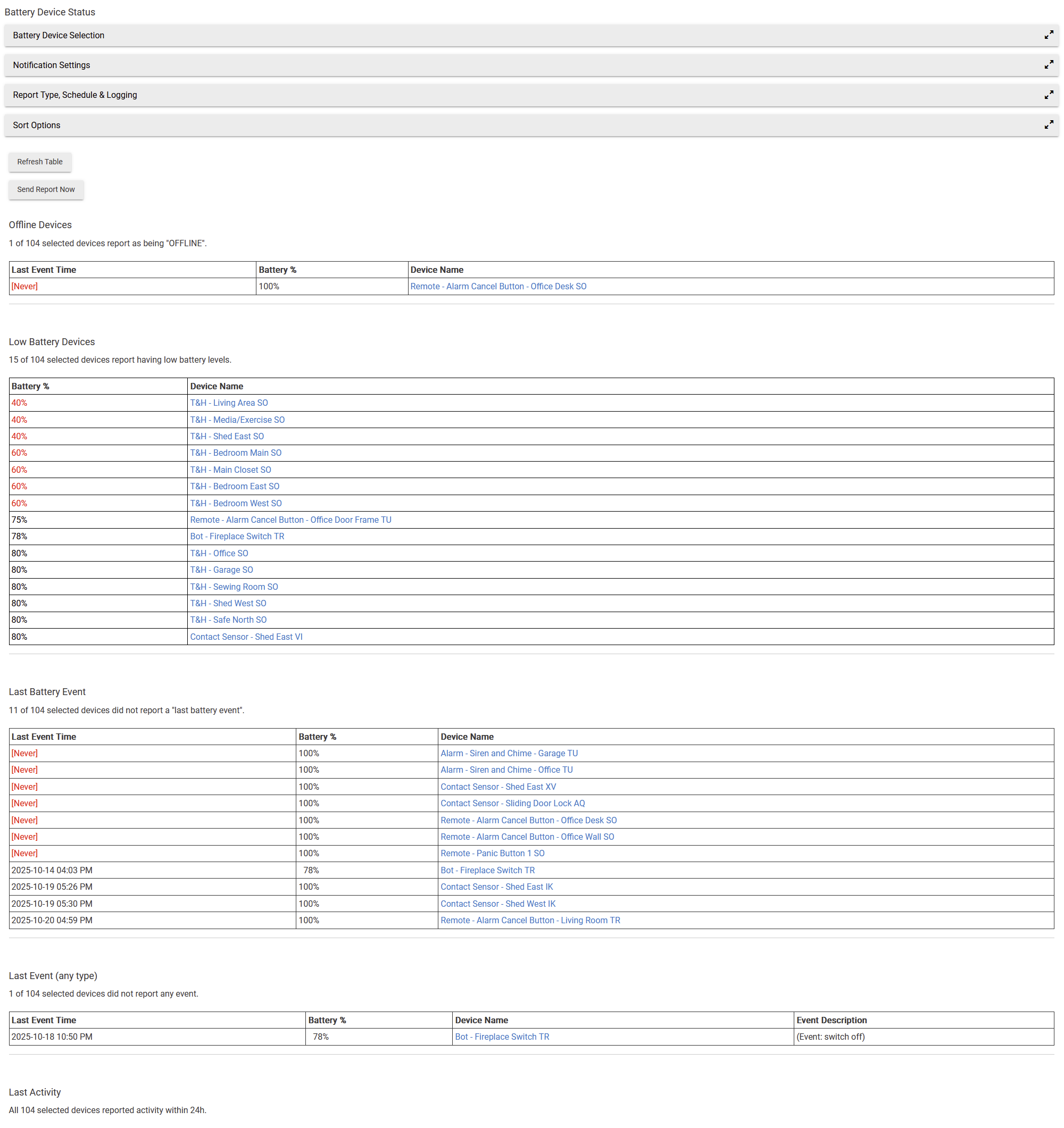

Sample "Refresh Table" output:
