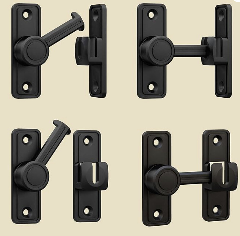

or this

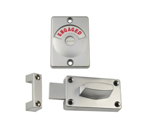

or this

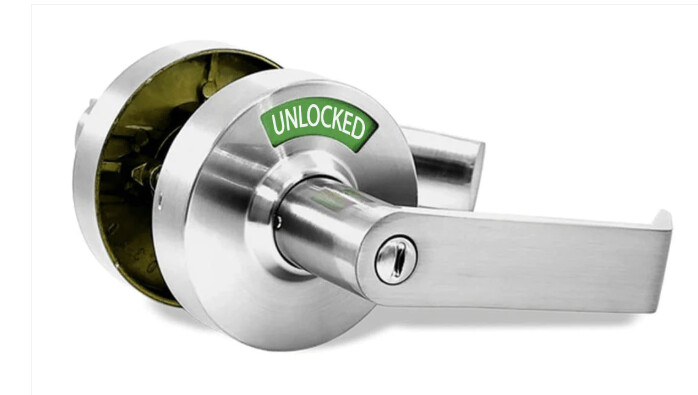

so i'd like something like this.
  • it/s for family home bathroom, so lock has to be lever or knob type. No touchpads, they'd look odd on bathroom door. Would scare off visitors.
  • indicates lock/unlocked state just like the first item above. Handy to have that visual display.
  • from inside it's a manual lock of some kind. Prefer it all manual as it inspires confidence. No battery operated motorised methods. Pure mechanical ones tend to last years without issues.
  • This is the tricky one, for it to somehow report it's lock/unlocked status to hubitat via zwave/zigbee.
I've tried looking but couldn't find such as item that meets all my needs. Has anyone retrofitted a sensor into one of these dumb locks?

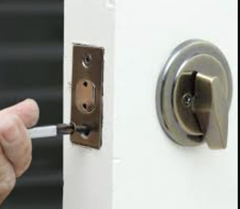

anyone retrofitted a sensor into something like this?
possible to put a reed sensor inside dead bolt hole, glue a magnet to end of bolt, and wire the reed sensor to zwave sensor.
Anyone done this?
Yes, this is how i handle my front door. I used Aeotec Smart recessed sensor 7 to keep it self contained. Battery replacement was initially a challenge, but i have a special paper clip now to pull the pcb out of its holder to make it easy. YMMV.
