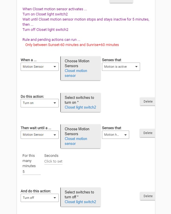

With regards to the specific question, Rule Machine would definitely work as @sburke781 describes. Basic Rule should also work. I haven't tested it but here is an example....

I am not familiar with ISY, but if you use Basic Rules as in my example, after you enter the logic to turn on and off based on motion, there are options for restrictions, where you would enter the sunset-sunrise times. Try it and you will see.
If you use Rule Machine, as in @sburke781's example, you would enter the sunset-sunrise times first as a required expression.
If you want to try the new Room Lighting app, which I recommend, there are options to restrict activation between two times.
Edit.....here is a marked up example of Basic Rule showing the restrictions.....
Thats exactly what I was looking for the isy wants restrictions first to see weather it should run where as hubitat wants actions then see if it should run. This is my disconnect with the logic. I think that way more traffic could be avoided if the logic restriction comes first where as it wont even look at a program if conditions are not
meet rather then look at actions then restrictions. But Im not certain to internal operations or logic behind hubitat. Maybe it does same thing just obviously in different order, anyways thanks. Also with isy you would do 1 long program eg. if between 10-12 turn lights on 50% or if between 5-9 turn lights on 70% or if xxxxx continues where hubitat uses rules for each scenario. So for each of these examples I would need another rule. Ill get it with time and help of community. My problem was I added the restriction first rather at the end. This is why I didnt have option for motion or switches. Thanks
