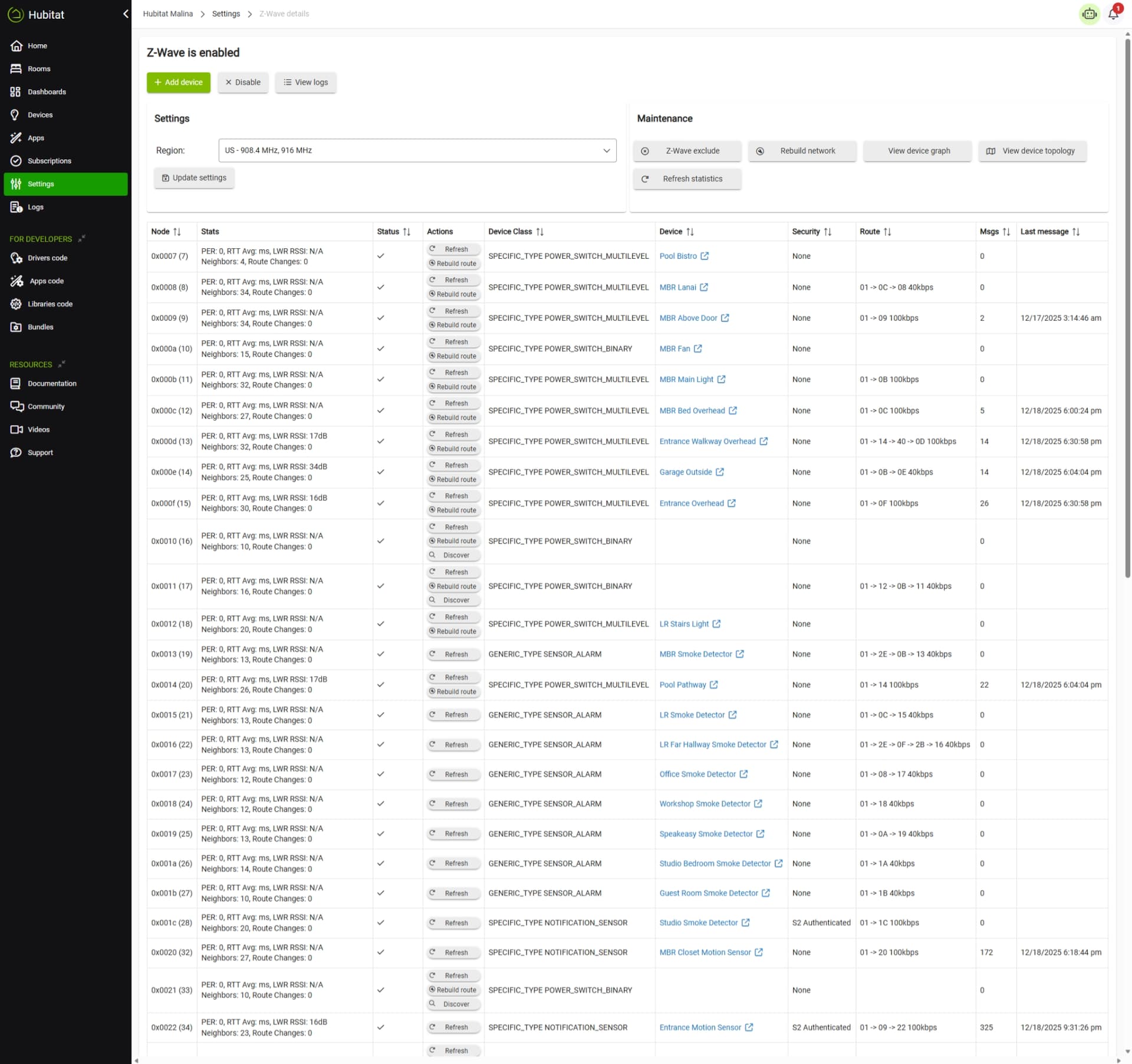

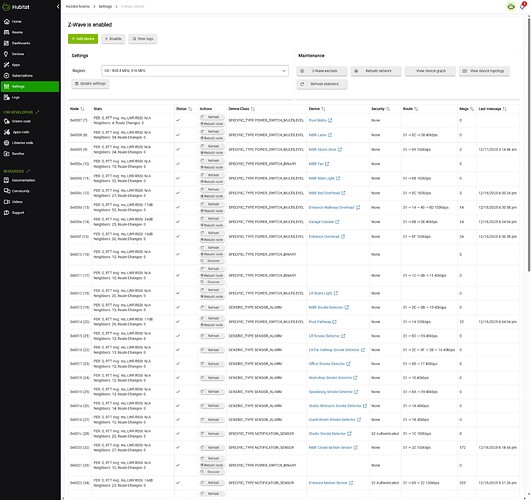

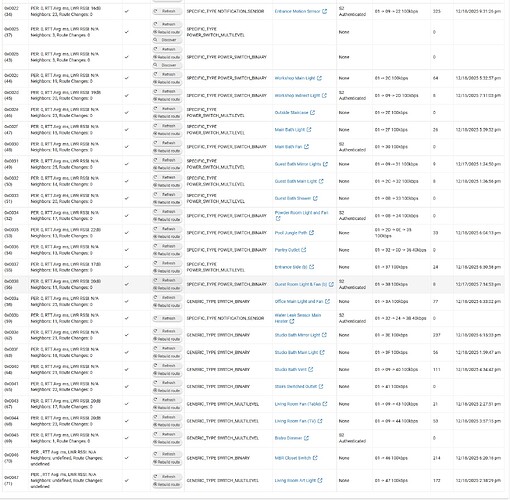

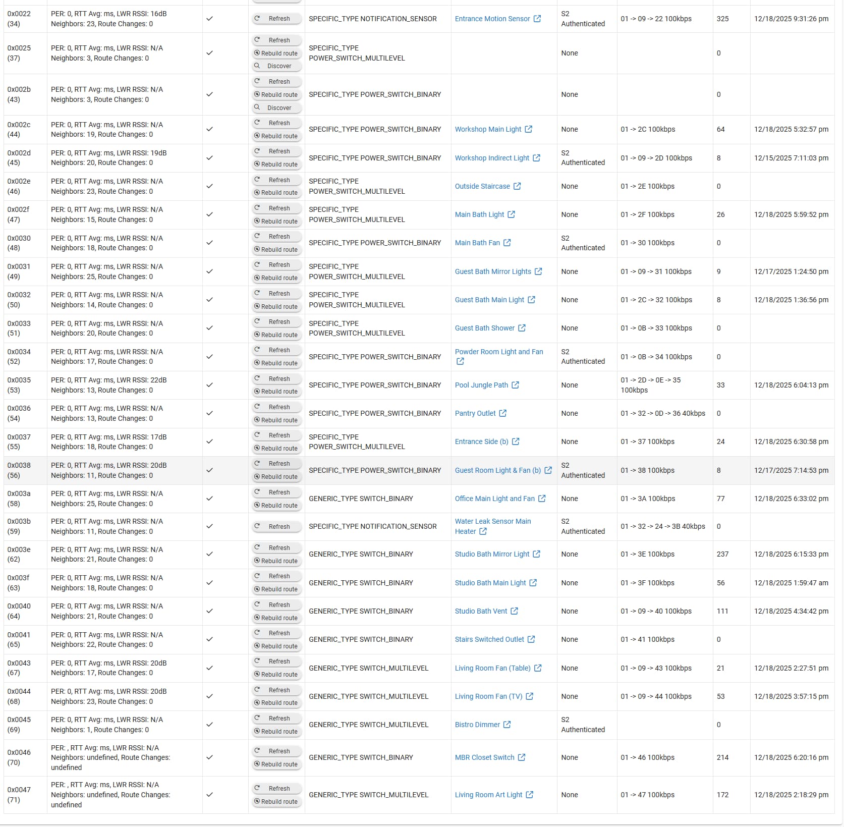

Paste a screen shot of your list of Z-Wave devices from the Z-Wave Details page. Your symptoms are consistent with Z-Wave ghost devices (a device that did not complete its setup and has no associated Hubitat device). These ghost devices frequently cause lots of issues.
Here is that screenshot. I do not think I have any ghost devices, but that may be now that I fiddled it, and they may have been there before. Only odd thing I see in here is devices that can't seem to route, but I think that is just some devices I have that are too far away at the moment.
Markus
The ones without blue links to Hubitat devices are likely ghosts. Here is a guide to their removal:
