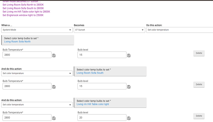

Basic rule setting wrong color
I have a basic rule for turning on my color lights and randomly they are turned on to a color rather than the color temp:
Last night, the living room sofa south light was green, and tonight the north light is violet.

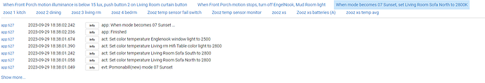

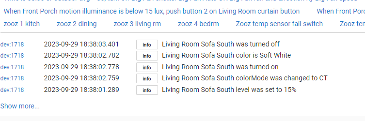

here is the log from the north light:
but the south light is different:
the north light failed to set the CT mode and temperature, so it just turned on to what it was last night.

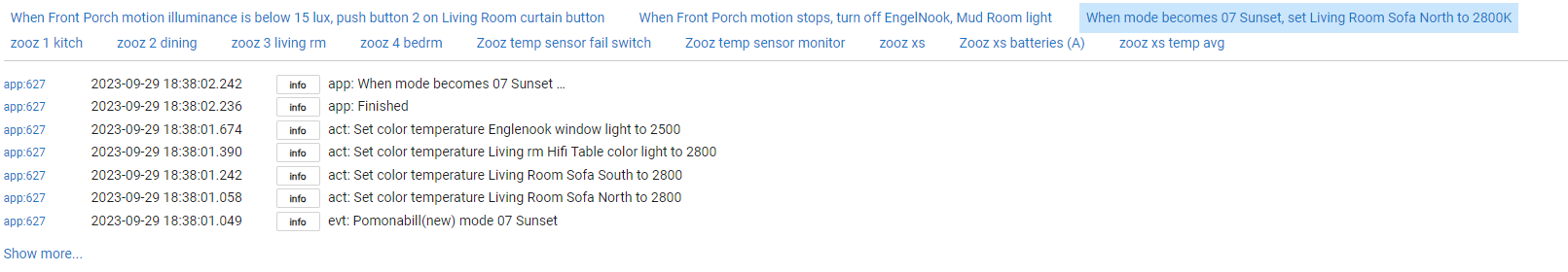

Here is a screenshot of the log for the rule
