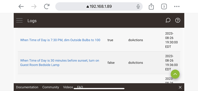

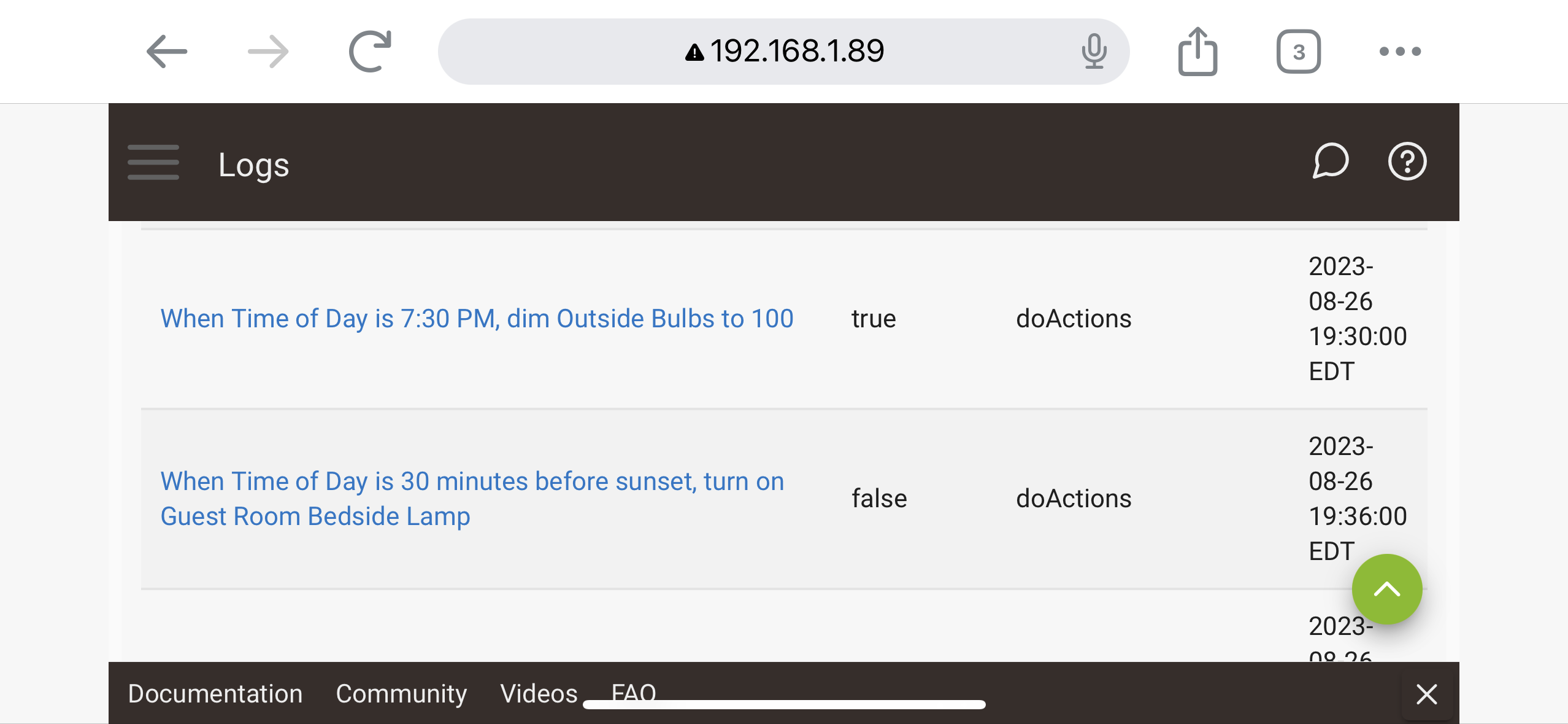

For what it’s worth here is the iPhone screenshot of the scheduled jobs
Not sure why it is false
My rule ran as expected and it scheduled a job for tomorrow. It's Recurring is also false so I think that's okay. Your rule isn't complicate and if you continue to have issues I suggest that you delete and recreate it.
