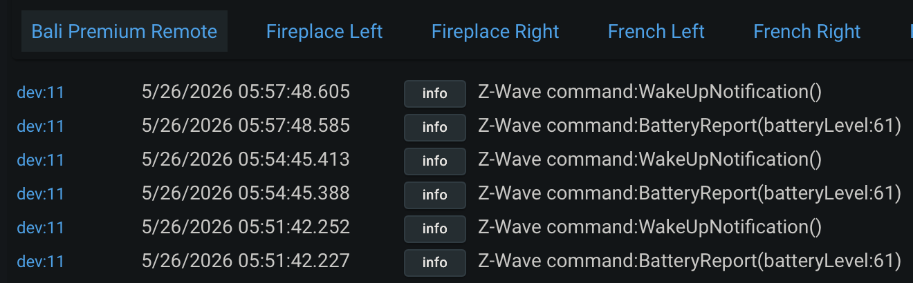

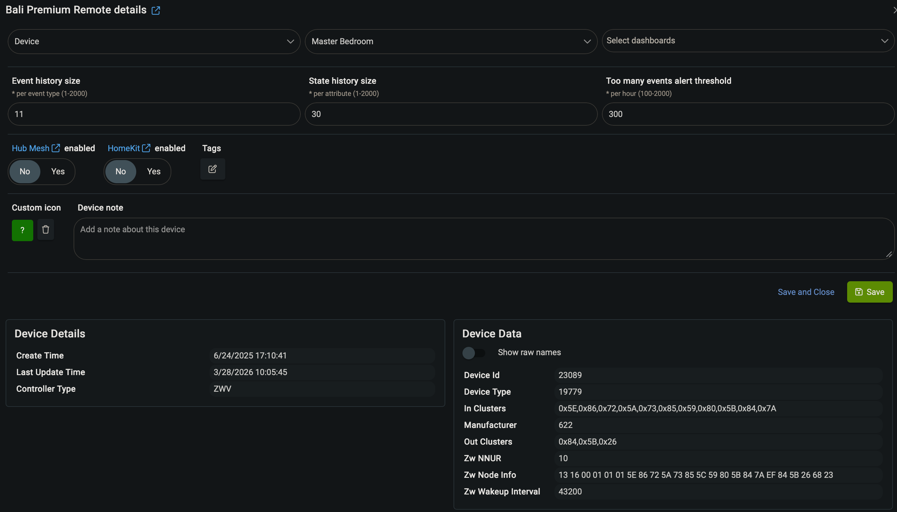

I have successfully installed and configured my Bali blinds with my Hubitat C8, to enable HomeKit integration and control with voice commands. I followed the instructions included with the blinds for integrating a third party controller. However, the 12 channel premium remote that I also have setup to control the blinds wakes up every 3 minutes to report battery status. This ends up draining the AAA batteries sooner than I’d like. I cannot figure out how to disable the wakeup or increase the time interval. Thanks for any help you can provide.
