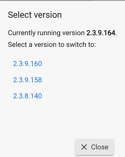

Question 1: Can I restore my local backup file 2.3.9.143.lzf while on platform version 2.3.9.164? If so, how can I do so? All my restore attempts end in a corrupt DB error. Soft reset did not fix the issue. Both attempts never complete the restore process. I cannot roll back to platform version 2.3.9.143 since I could only see the below platform versions in Hubitat Diagnostic Tool - restoring the previous version option. Please note I have several ZigBee devices and I hate to do a full reset.
a) 2.3.9.164 b) 2.3.9.158, 2.3.8.140.

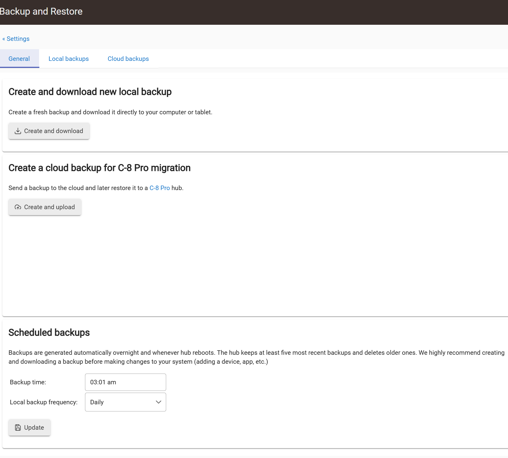

There were no database changes between .143 and .164 so the data should restore fine. just go to Settings|Backup & Restore and select the option to upload and restore a local backup.

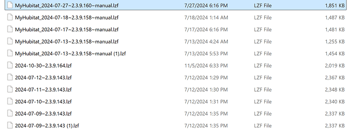

I couldn't reboot with the rebuild option, but I managed to resolve the issue. I had many backup files; some files have the keyword "manual" at the end and some don't (see below screenshot). I tried restoring the backup files without the word "manual". The restore kept failing. But when I tried the backup file with the word "manual" while on Platform version: 2.3.9.160, the restore worked perfectly. I am pretty sure the backups are not the same kind. I'll keep you posted. Thank you for your assistance.
Is there a difference between "Create and download new local backup" and Scheduled backups? I couldn't restore the scheduled backups on the "local database" tab. The manually downloaded backup worked fine. I am glad I didn't lose any data.
Only difference should be where they are stored. The scheduled are stored on the hub where as the others are downloaded to a location you designate.
