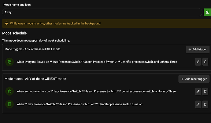

I'm not 100% sure from your screen shot, but if you're using the integrated mode manager, the 'exit away mode setter' is an internal app and not where you want to edit the mode actions.

I'm using the integrated Mode Manager. This is what my Away looks like. Note the "+ Add reset trigger" button. This is what you use to set the exit condition. This has been rock solid.
Sorry- I did not add that scene shot. I have added the Presence sensor and switch comb as an off portion to see if it helps but I do not think it will. It shows the presence sensors arriving home but Hubitat fails to exit away mode.
I just noticed that in my haste to shift to integrated mode manager, I did not set Day, evening, and sleep time triggers. So when I returned today, I would assume it had no basis for what mode to set since I did not have value triggers set.
So I will need to test this to work in coming days. It did not work on the OLDER Mode manger with all day, evening, and sleeptime values set.
