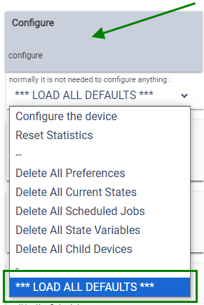

Please update the driver manually :
https://raw.githubusercontent.com/kkossev/Hubitat/development/Drivers/Zigbee%20TRV/Tuya_Zigbee_Thermostat_lib_included.groovy
I have added a new device profile 'AVATTO_ZWT198_ZWT100-BH_THERMOSTAT'
After updating the driver, select 'LOAD ALL DEFAULTS' and then click on the 'Configure' button above :
Let me know if it works.
Work perfect thanks for the update now the temp IS ok
