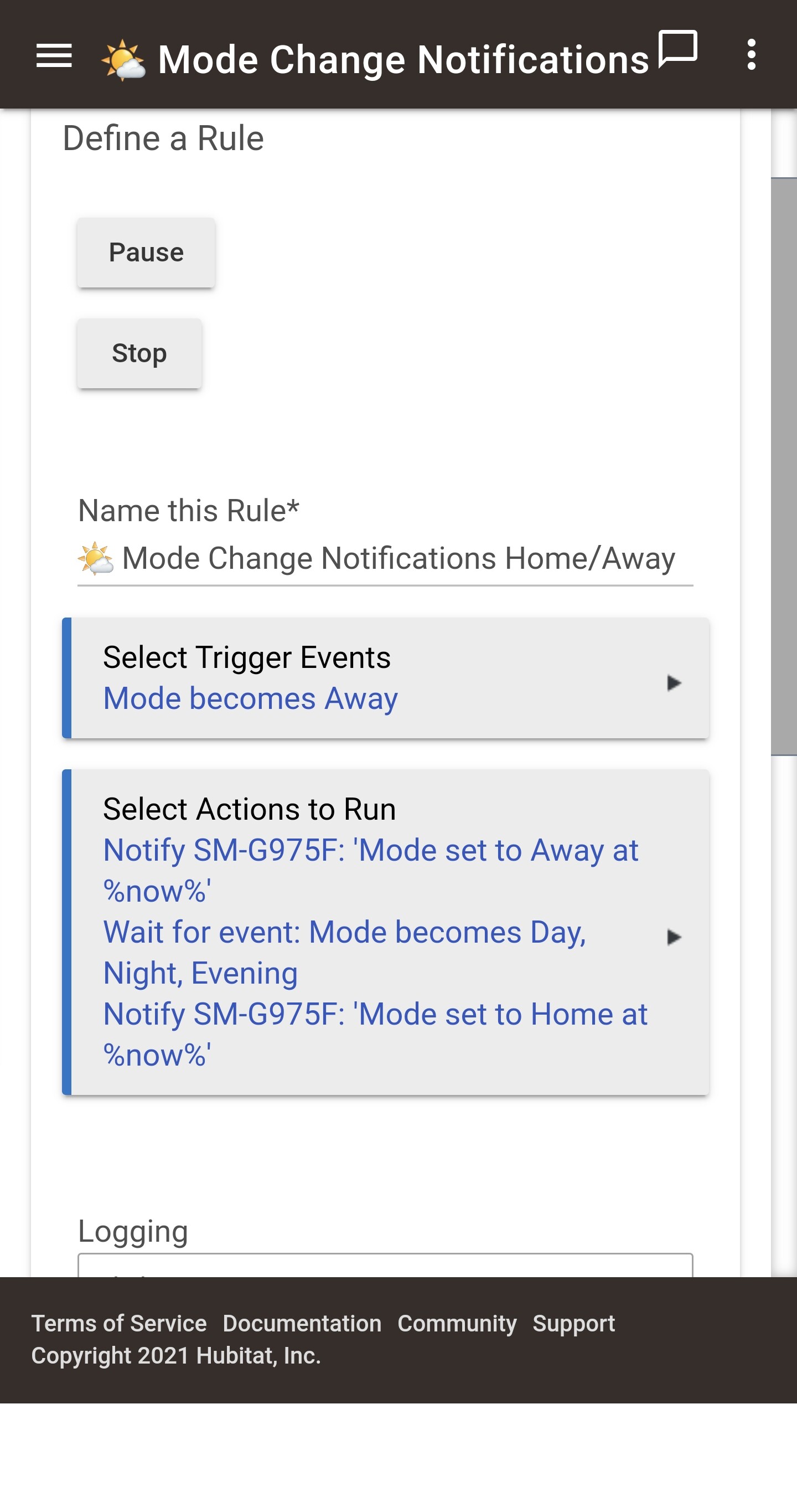

I have a similar rule, this is how I solved it. Should work fine for what you described as well. No need to create any extra virtual devices or variables.
This is brilliant! Exactly what I was after. Cheers!
Late to this party. I had a similar requirement and reading through tis post I made a slight change to @MrPancake solution by replacing
with
So it will still work if I create more modes later
