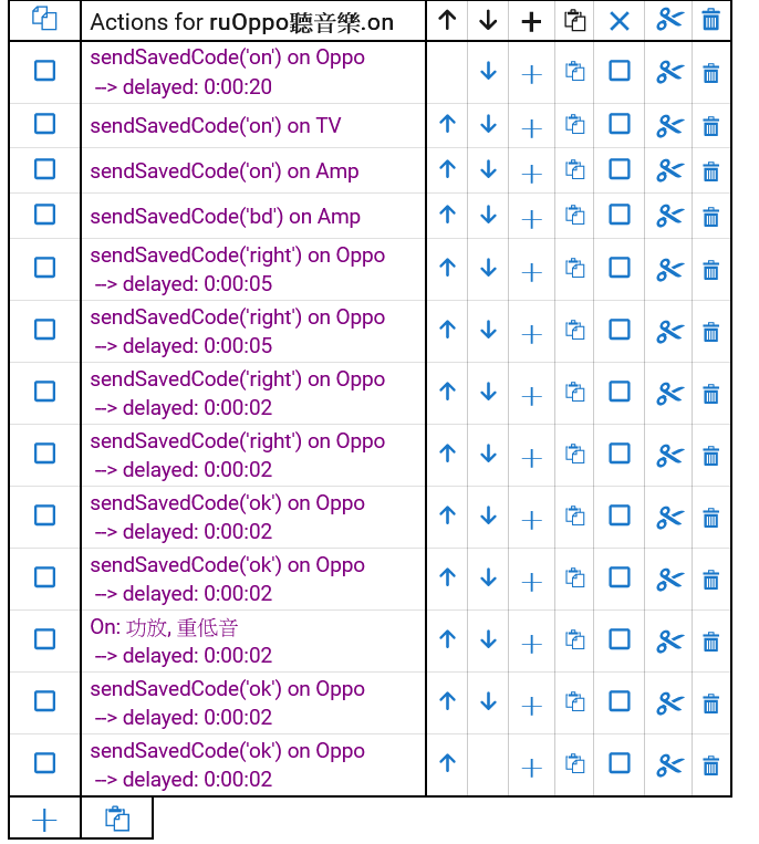

However, when I try to automate these steps using Rule Machine, the music doesn't play correctly. I've tried adding delays and waits between the actions to give the OPPO time to process each command, but it still doesn't work.
I checked the logs and noticed that no matter how long I set the delays or waits, Hubitat sends all the commands immediately without pausing.

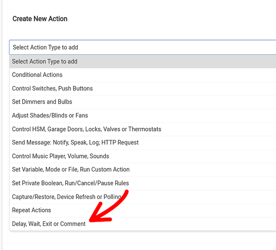

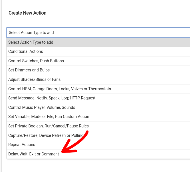

Be aware that all those "delayed: 0:00:02" will all be schedule to run at the same time 2 seconds later. They are not inserting a delay between each command.
Maybe delay would be preferable here. As the name imply, WAIT would wait for a condition as DELAY will not. Same action choice though:

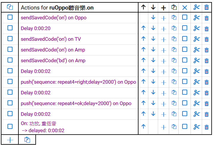

I followed tomw's instructions and got it working. Here's the updated screen dump
Thanks a lot !
