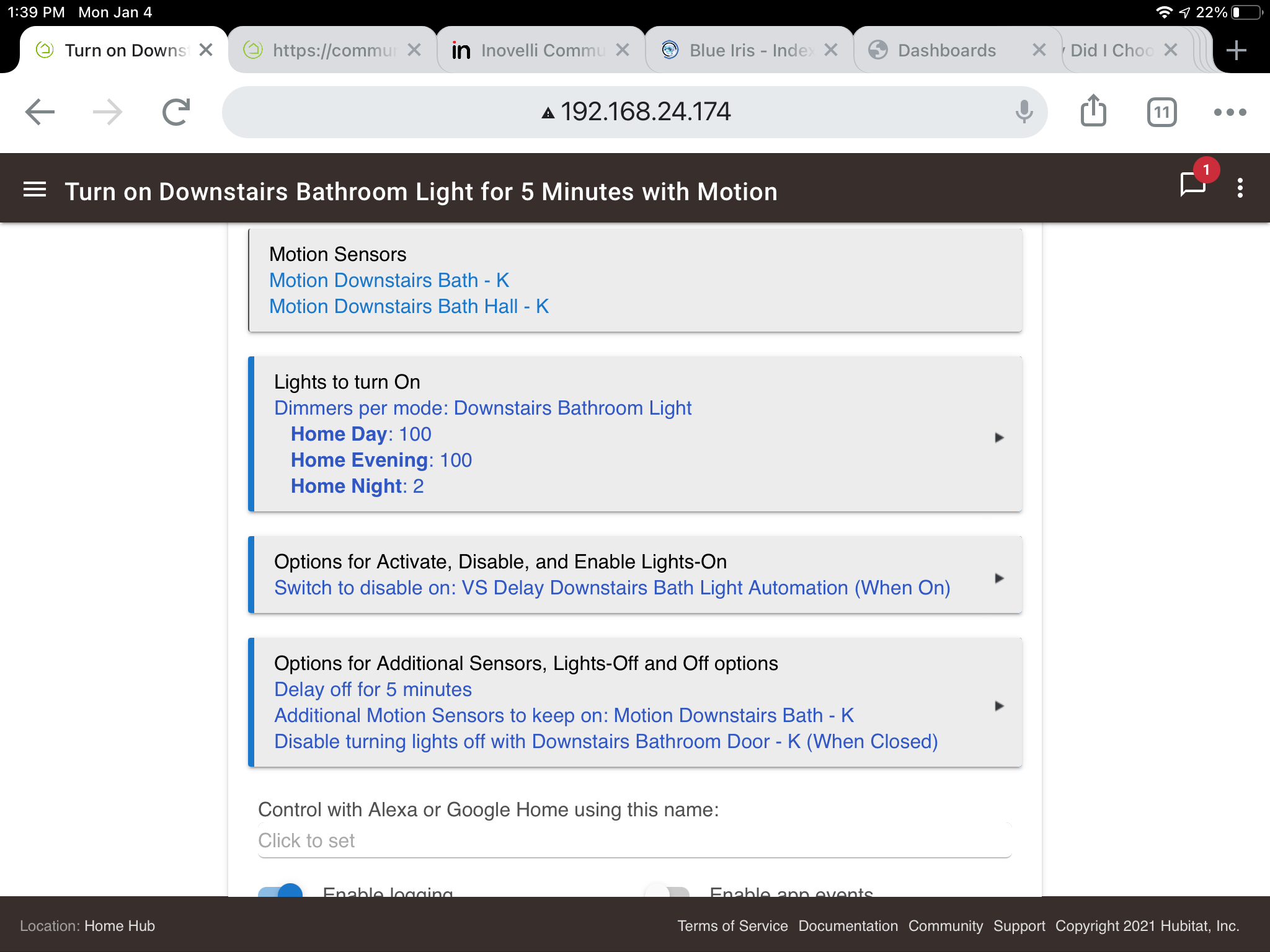

I'm controlling my bathroom lights with motion as well and use a contact sensor on the door so when the door is closed it will keep the lights on, I also have a temp/humidity sensor (in another rule) in there which controls the fan when the humidity gets high enough but only when the door is closed as well because in the spring we sometimes will keep windows open when the humidity is that high although not condensing and I didn't want the fan coming on for that.

This is what I have. Works very well. Haven’t failed me yet.
