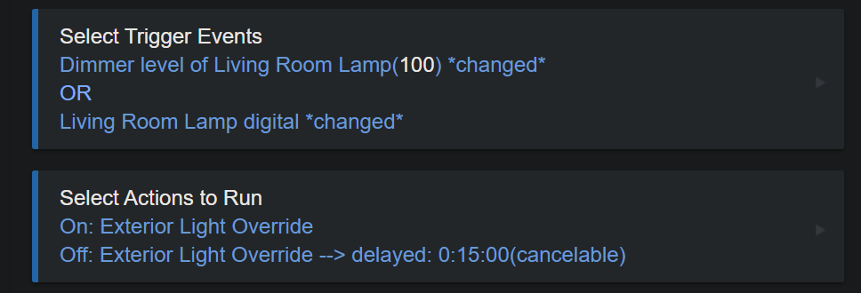

I've created a virtual switch that I use to override lighting automation; if the switch is on, the automation just exists there.
I wanted the switch to get set whenever the lighting was modified outside the automation, stay overriden (on) for 15 minutes, and then reset the state (off).
For some reason this is not working with either Delay 00:15:00 or with Off:Switch --> Delayed 00:15:00. The switch gets turned on, but never turns off.
This is how it currently looks:
There's no reason that rule shouldn't do something, even though that "something" may not always be what you expect (but should definitely include an "off" at some point). It's possible your device just isn't responding to the "off," but you can tell what the rule thinks it's doing for sure by turning on logging in the rule for at least "Actions" (and "Triggers" is usually helpful, too). Then you'll see what it's doing when and will have a better idea of how to troubleshoot--or where.
It should be noted that any trigger event firing will cause your actions to run again from the beginning, and nothing here is ever cancelling that delay--so this is why I said above that it may not always do what you expect. If the light turns on digitally, then sometime adjusts the level 5 minutes later, you'll get two scheduled "off"s: one for 15 minutes after it turned on, and another for 10 minutes after that (15 minutes after you changed the level). This also means that if you turn the light off at minute 11 and turn it back on at minute 14, it will turn off 1 minute after that--not 15 minutes. If you want these actions to "reset" the timer, consider using a "Wait for event: elapsed time" instead, which is cancelled on re-trigger. You could also mark that delay as cancelable and run a "Cancel Delayed Actions" before it gets re-scheduled, like at the beginning of your actions. If you want to wait for 15 minutes from the first event, you can do that with a bit more work, maybe enlisting Private Boolean and only scheduling the delayed action if Private Boolean is true (then setting it to false before starting the delay and back to true after the delayed "off").
But, that wouldn't explain the issue you describe...so logging is your friend for now. :slight_smile:

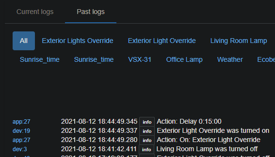

Sadly, no - nothing happens. I manually turned the override switch off, activated a change in lighting, waited a couple of minutes, and it didn't turn on. Then, I manually ran the rule in RM, and the ON action triggered, the delay was registered, but the OFF never happened.
Log as follows:

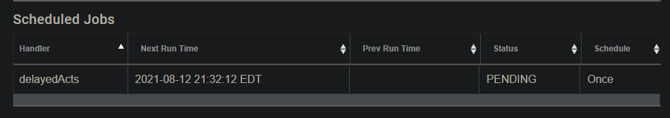

When you're waiting for the delay--which the rule does appear to be scheduling--check the "App Status" page for that rule. You can get there from the gear/cogs icon next to the rule in the app list, or the same icon on the top right of the rule page. Scroll down to "Scheduled Jobs," and see if you find something there--you should--after the delay is scheduled (and disappear after it should have run).
I get this delayedActs but its unclear to me what Action is going to be taken at that time. I didn't change the Rule, so I have no reason to believe that this time will result in it turning Off either :laughing:

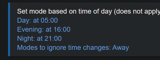

Something else might be off, because I just noticed that my mode manager is not changing mode at the scheduled time... (it's 21:37 as I type this; yes, I checked TZ and time on the hub :grinning_face_with_smiling_eyes: )
Sounds like you've already checked Settings > Hub Details for the correct time, time zone, and location, but if not, verify it there. :slight_smile: Otherwise, something does indeed seem up. I might try a reboot if you haven't already, then consider going back into Mode Manager and the problematic rule and hitting "Done" (which generally saves the app's settings and re-initializes things like subscriptions and schedules).

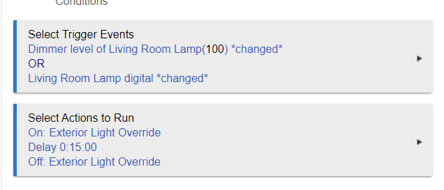

Sadly, the post-delay turning off of that virtual switch (when run manually) simply doesn't happen. And I'm wondering, is that even the right way to sequence those that On->Off with 15mins in between (irrespective of being cancelable or resettable).
Yes, that should work (even if unexpectedly after a retrigger). A standalone "Delay" action like you have effectively pauses there, the schedules a job to resume at the next action after the delay.
Deleted the rule and recreated it like below, and now it works... :roll_eyes:
I wonder if just re-creating it would have worked, too. The two rules you posted would be identical in outcome in this case. The difference with putting a delay on an action as opposed to using the standalone "Delay" action is that the former schedules that particular action for the specified time in the future and then continues with the next action, while the latter (as explained above) effectively pauses there until the delay is up. Since you don't have any actions after this, there would be no difference in this case.
