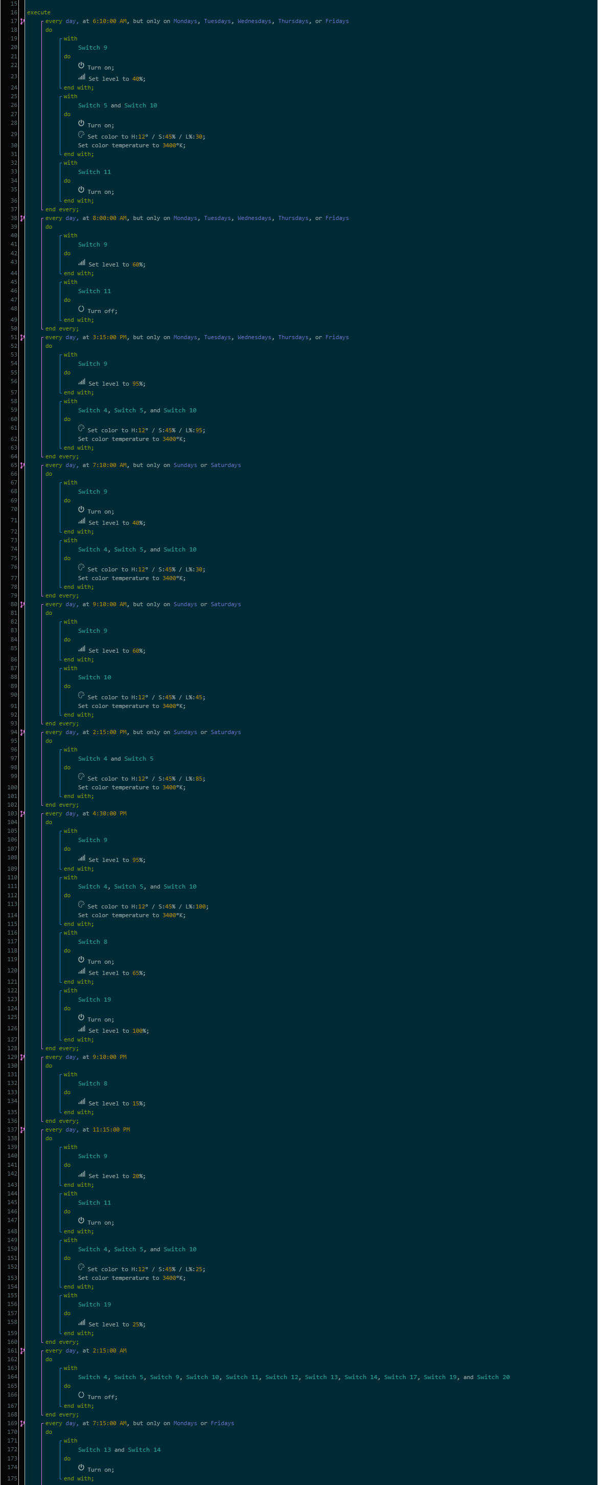

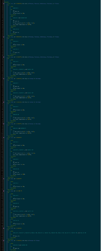

  • I'm using WebCORE as my lighting rules engine. Using one piston my lights change level and on/off at certain times during the day.
  • I issue commands through Google Assistant to turn lights off at night
I've noticed if I go to bed early and issue a turn off all lights command, that they will just turn back on when the next lighting change takes place. I'd like to have the automation ignore steps until a specific time the next morning if I've issued the turn off command through Google routines. I'm not quite sure how to approach a setup like this.
One way is to set a virtual switch when you do the all off, and have the piston check to make sure that the switch is off before proceeding.
So is your piston turning the lights back on, if so please post so folks can see it.
