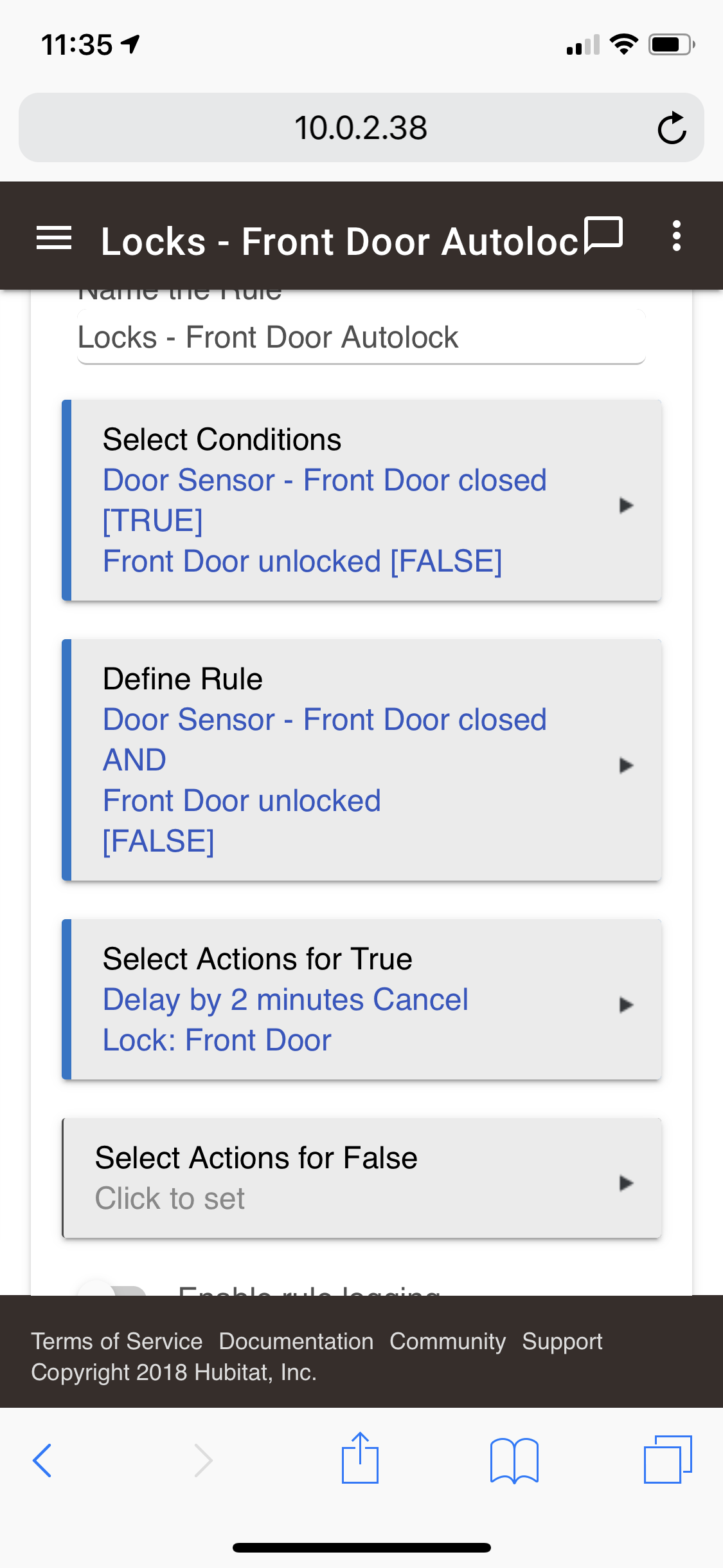

Should this be a rule or trigger rule? I am not having any success with my kwikset 888 locks refreshing correctly, or this rule executing reliably.
I do it with a triggered rule and it works great. Trigger is just front door unlocked. Works for manual or digital unlock.
In the absence of triggers, conditions effectively become the triggers.
The way you have it (with conditions instead of triggers), you are allowing either the door status or the lock status to call the rule to be evaluated.
The rule will be evaluated as true if either of the following happens:
  1. The lock becomes unlocked while the door is closed
  2. The door closes while the lock is unlocked
Personally, this is what I would want in your scenario.
However, if you only wanted the door to lock in scenario 2 above, but not 1, then you would move the door closing to a trigger and leave the lock being unlocked as a condition. This way, the rule is only evaluated when the door changes state, then once that happens, the state of the lock is checked to determine if the actions should execute.
IMO you have the rule set up correctly, the issue is the lock not reporting it's state changes correctly.

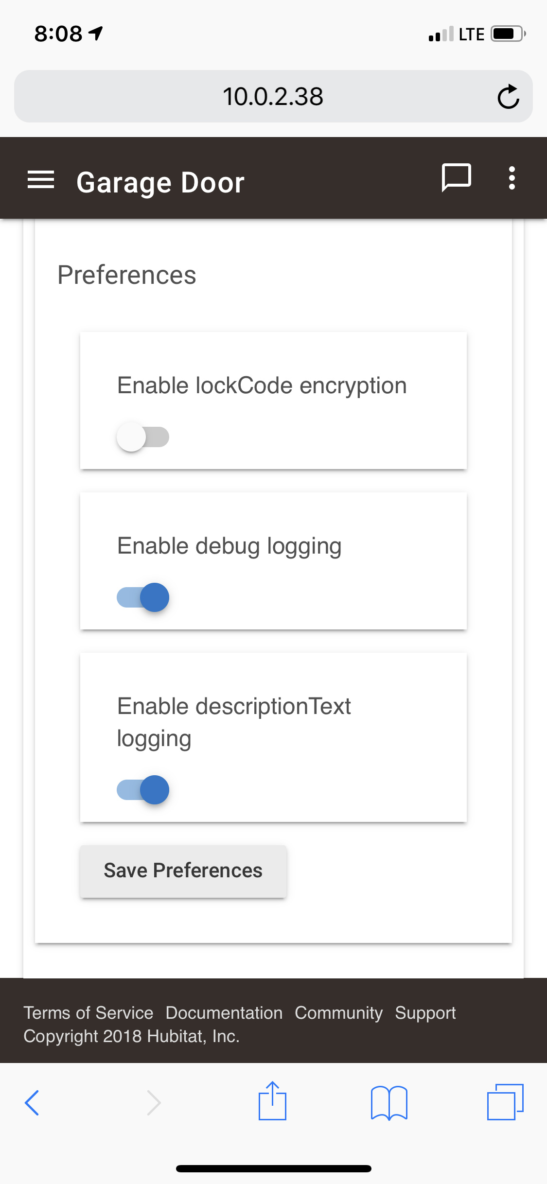

Interesting. My front door lock works correctly for showing up in the HE logs when I lock/unlock through the device. The Garage Door does not show any logs BUT the RM rule executes. I have no logs for the Garage Door lock.
Perhaps logging is not turned on. Go to its device page.
Been logging the entire time

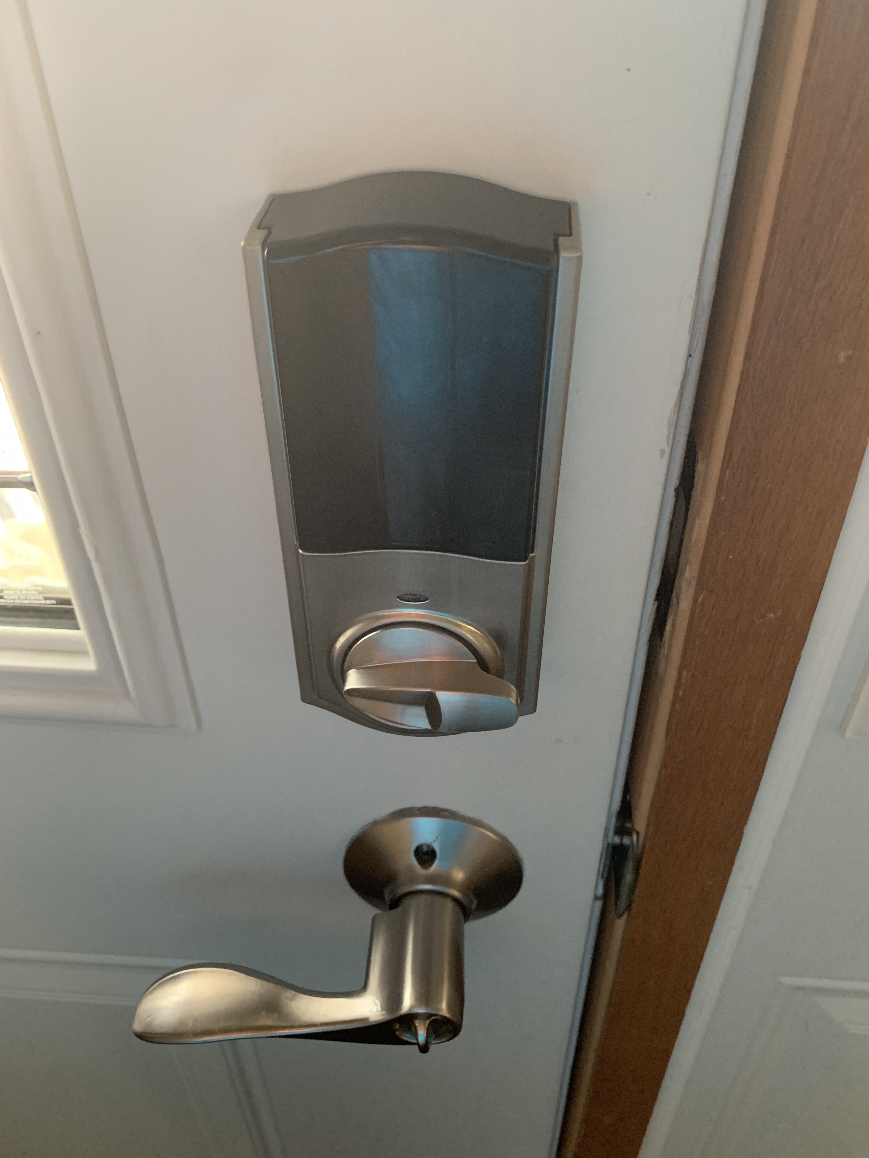

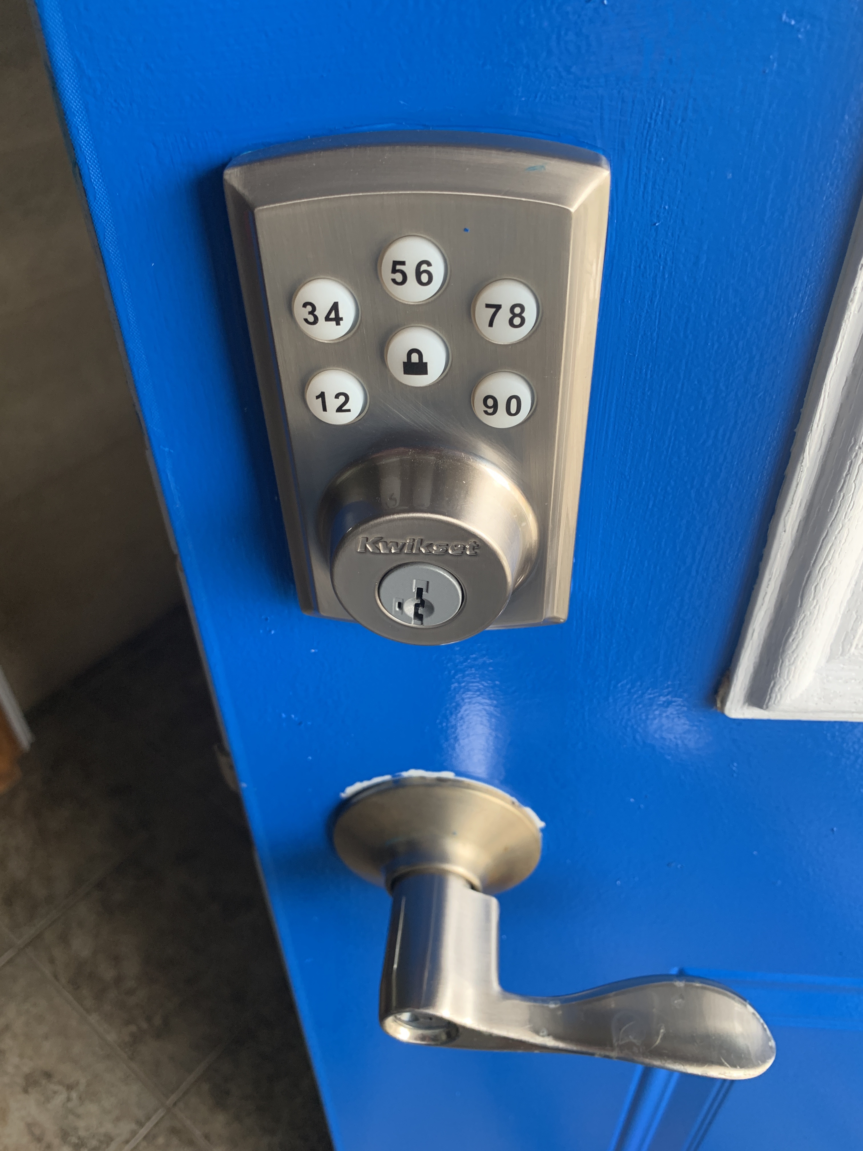

Alright guys. I have excluded and the re-paired the garage door. HE still does not log anything for this device even with full logging enabled. Thoughts? Ideas?
This is a Kwikset 888, using the generic lock driver, and physical lock and unlock do not always report state changes?, is that correct.
Do driver commands work 100% of the time?
@mike.maxwell
Yes this is a Kwikset 888 using the Z-Wave Generic Lock Driver. Physical lock/unlock do not always report.
If I use the driver I can lock/unlock 100% of time. The add/get/delete codes freezes up a lot resulting in me having to pull power on the lock and then repowering to get to register again. The driver is not reporting in the logs when I use the driver to lock/unlock.
I have another lock (Front Door) which is the same Kwikset 888. It also does not report refresh on physical lock/unlock. I have not had the freezing/lockups when using the add/get/delete codes (yet). The driver DOES report in the logs whenever you use the driver to lock/unlock.
Keep in mind prior to 1.1.16 I had zero issues with these locks. I thought it was me and the refresh just needed to be initiated. I created a rule in RM to refresh the device every minute. Pros - the device become more consistent but still was only 50% reliable. Con - go through batteries within about 2 weeks.
