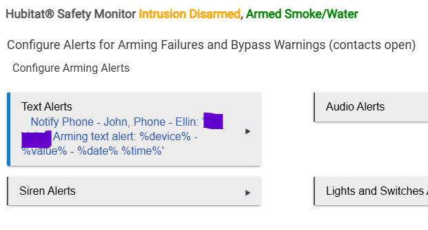

I am on a C8 hub with the lastest version installed. Other than removing the 2 sensors from the Open/Close setting, nothing else has changed. Before, I did get the notice but only 1. The Message I get is "Arming text alert: Door - 4 - Master Bedroom - bypassed - 02/15/2026 12:03 PM)" I get these 4 times within a minute. The app logs show the HSM is only getting armed once.
Here is a screenshot of the setting.

The copy/paste without formatting makes things a bit hard to read, but you might have just two sets of "duplicate" notifications: one when you first tell the system to arm (i.e., when the arm delay starts) and another when it actually does (i.e., when the delay is up). Is it possible something is actually arming your HSM twice? Like a rule that responds to mode, HSM status, or something else and does something itself with HSM? That could explain the second set of things.
I can't also help but notice that the newer ones are also exactly 1 minute apart, which tells me you might have "repeat until cancelled" turned on for HSM alerts, but I don't see that in your screenshot above. It might be worth turning it on and turning it off again if you still don't/didn't have it enabled.
I was able to reproduce that first thing and am not sure if it's actually a problem or by design, as I could see it being either since there's a delay that could allow you to fix things if there's something you want to address in the meantime (e.g.,a door you really did mean to close before arming). The rest ... I'm not so sure about. :slight_smile:
The only alerts I have set are the Arming alerts. It is not set to repeat. I am baffled on why I receive these 4 times.
