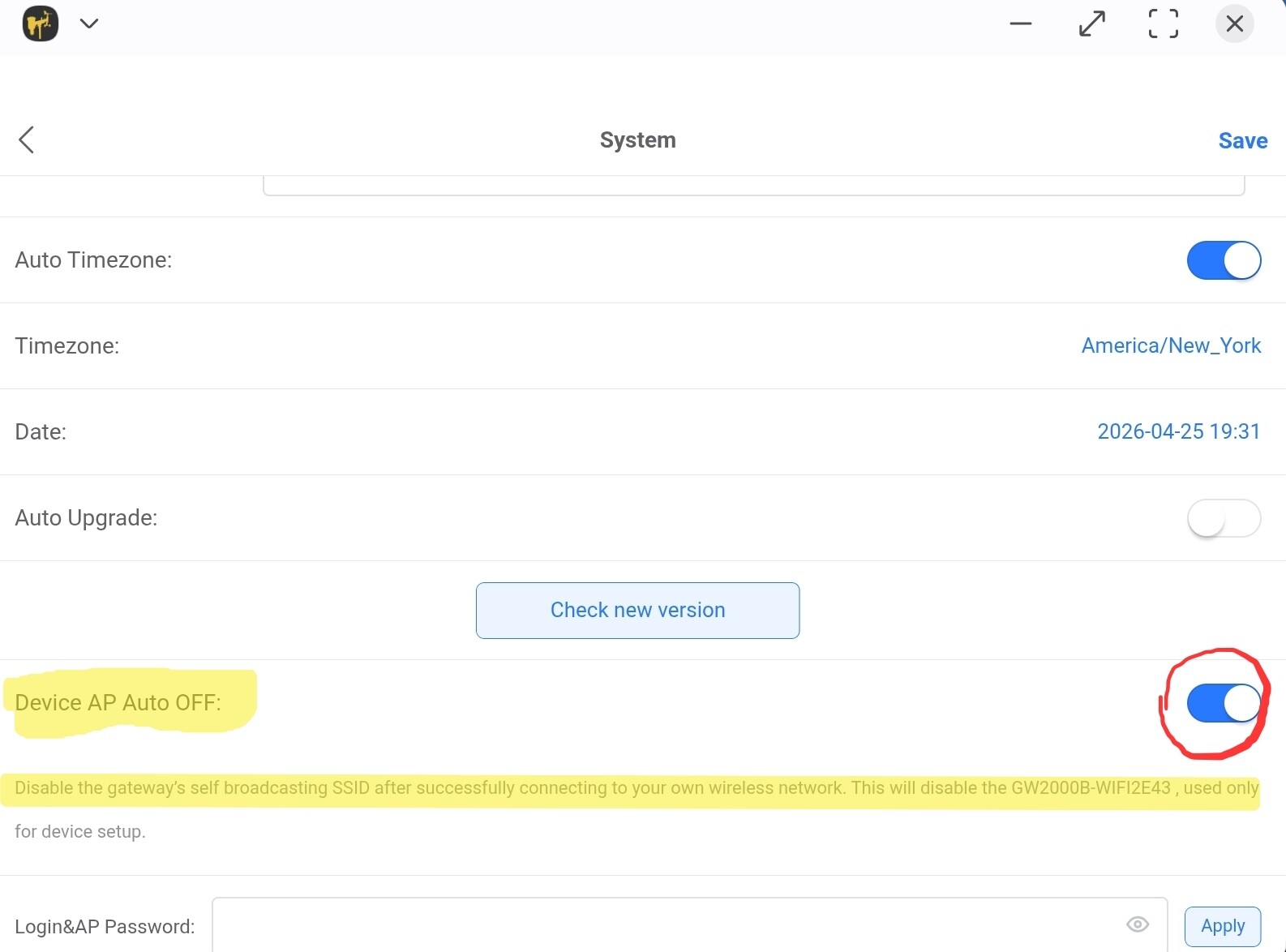

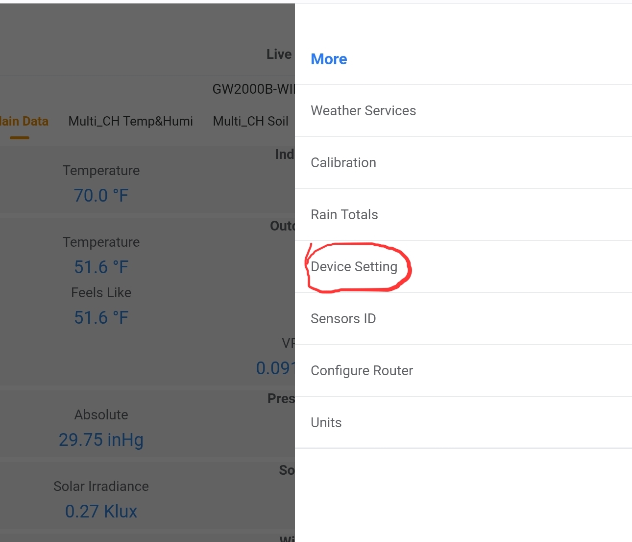

Is the device still broadcasting the setup SSID? I seem to recall that there was an option to disable that once connected. However, if it is till broadcasting the setup IP, you may need to connect to that one again to unlock WSView plus.
If you go into the device list, and click more -> Device Setting, check and see if the disable AP button is on.

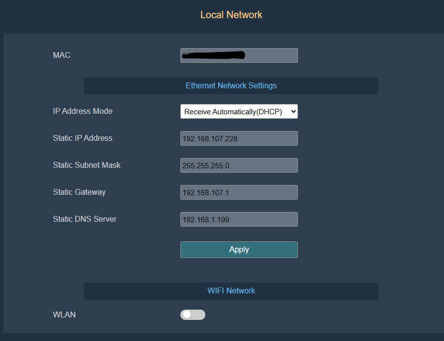

Try just going to device's IP address in a browser. You should be able to turn WLAN on/off. Mine is using ethernet. It's not same PW as the app; I think it starts w/out a pw for admin user.

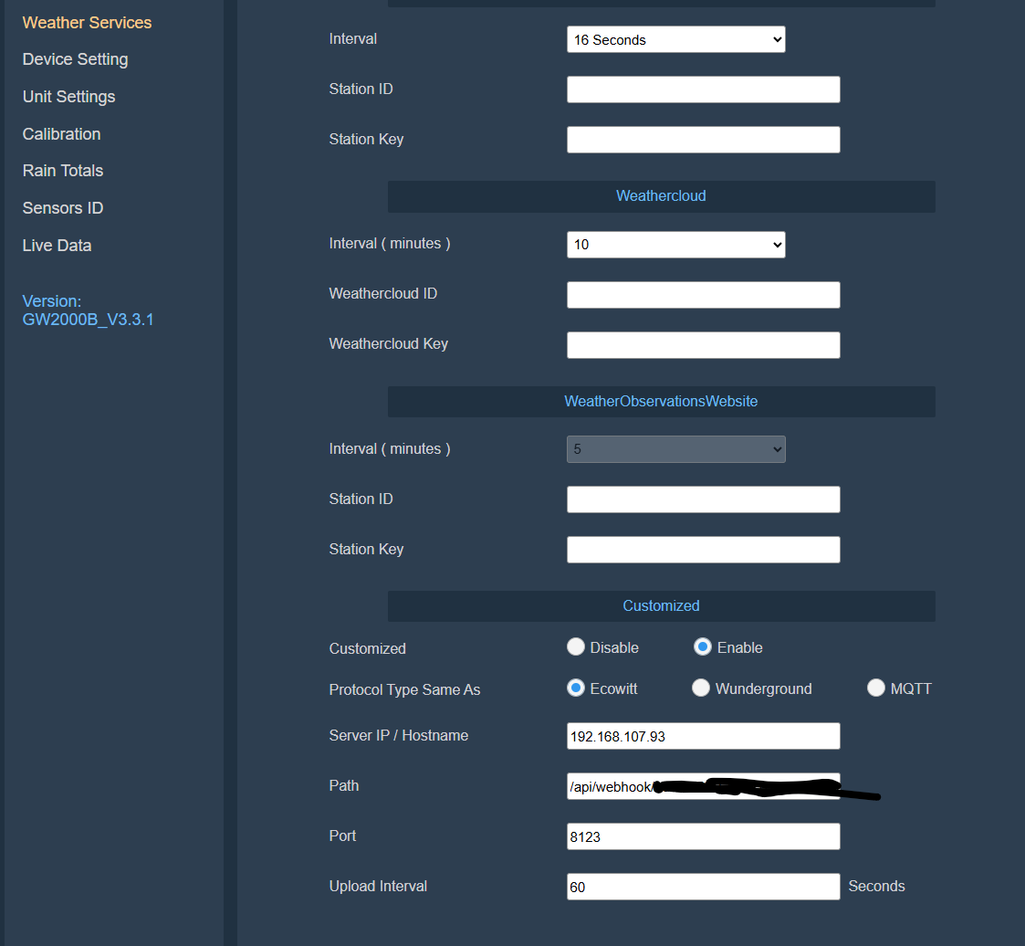

Using Weather Services, this was how I set it up to send data to either Hubitat or Home Assistant.
Mine is currently integrated to HA so this isn't exactly the same to connect to Hubitat but close. I know the path is different for Hubitat and I believe the port is different also.
Per @stephen_nutt's post... The settings for Hubitat are:
Server IP/Hostname = Your Hubitat's IP/Hostname (IP is generally best)
Path = data/report/ (This should be the default value)
Port = 39501
I just moved mine back to Hubitat and my path was just /data. I didn't try /data/report also though.
I wish it would allow more than one customized weather service at same time so i could send data to Hubitat and Home Assistant.
