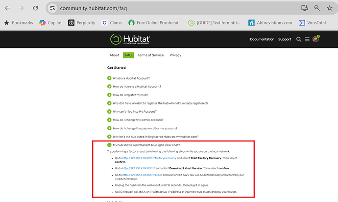

I found the document I used and thought it was official. Is it not?
@bobbyD @bertabcd1234 see screenshot above. Appears to be an ancient FAQ on the community site. I did not even know that existed. Someone will need to get it updated or removed.
https://community.hubitat.com/faq
