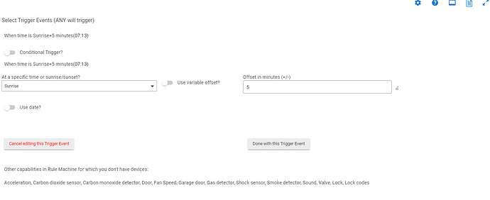

What I want to do is use the sunrise & sunset functions but assign a random offset to give the house that lived in appearance so I am attempting to use this function:
versus this function which appears to assign a fixed offset:
The issue that I am having is that when selecting the variable offset toggle the adjacent drop-down box is empty. I was anticipating a range of minutes to select from in the drop down list to limit the range of minutes that would be randomly changed (at what intervals I am not sure). This "range of minutes" would be so at sunset / sunrise + or - this random offset range would give the changing appearance (preferably daily) of someone turning the lights on & off at different times (sunset / sunrise + / - random range of minutes selected in the drop down box).
Am I way off on this one?
As always thanks for anyone's insight.
Don
Blame the English language ….one word having multiple meanings. Variable in this context means a predefined private or global hub variable, NOT a range of values.
Like @fritz mentioned, you need to create a Number variable and reference that from your rule. You can then use another rule to randomize the variable value.
I knew I was missing it. Thank you so much!
Don
