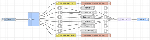

Unfortunately that's not true for all flows - particularly ones you import (or ones with function nodes) .
NR has no left to right flow requirement. What I mean by that is any node in any place in your visualisation may be triggered and create follow on actions so not everything originates on the left - or even in the same flow you're inspecting. This makes it impossible to easily understand a flow by examination. If they're your flows you can add 'discipline' here to make it more intuitive. I strongly recommend this. For me even two weeks later I think did I author this ! Function nodes (and sub flows) really obfuscate this.
An RM rule or an app code construct does not have these issues. As you expand your NR flows (and I have a lot and love it) you will experience the 'what did that' scenario which whilst easy to debug is quite frustrating and time consuming
