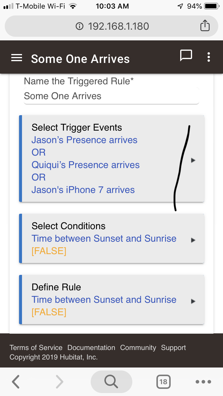

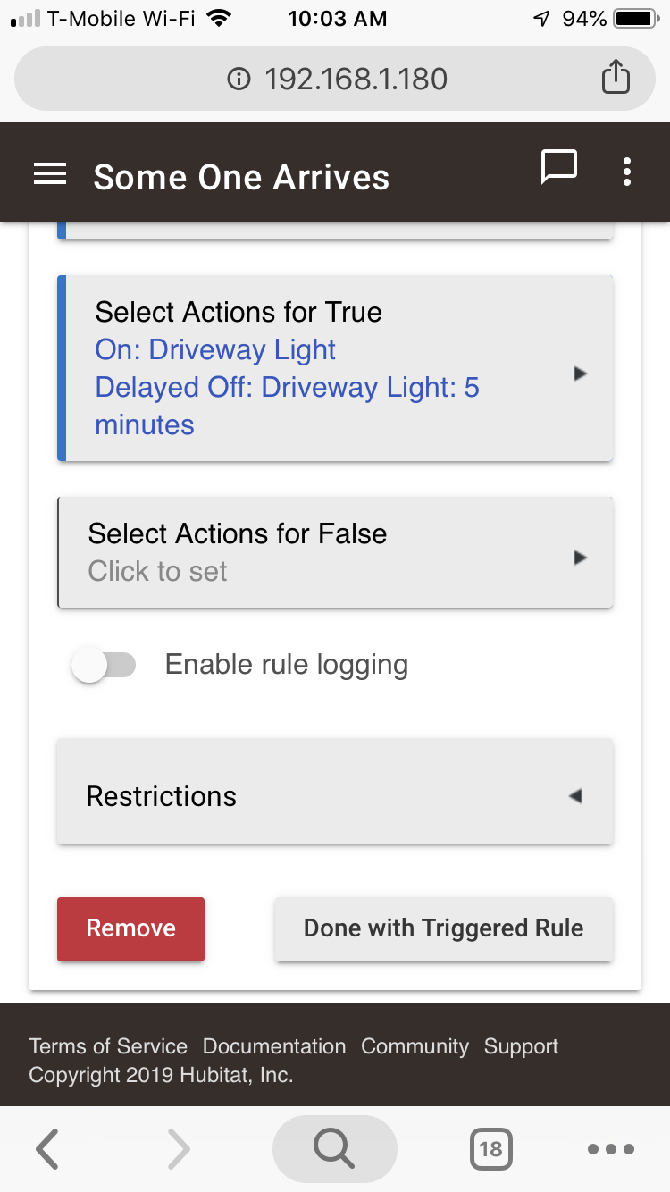

Here is one way of doing it using a triggered rule. I’m sure there are other ways.

Thanks guys...I see my error was not using a "triggered rule". I got it working I think!
