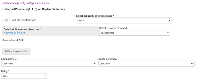

If you use @csteele driver you can turn it off like this:
There might be a simpler way thought. I could'nt find it.
Also I don't know if the built-in driver have a command to do that.
