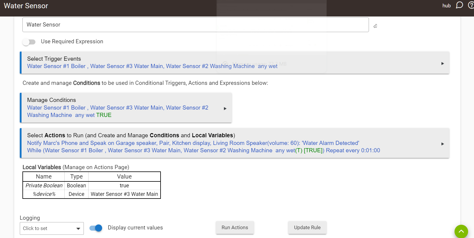

So I have a RM working. I can not figure out 1 thing. How can I repeat the check ever minute until the devices is dry. Not turned off in Habitat. If I dry the sensor on my shirt, I want it off, if it stay wet, repeat msg ever minute.

This is my rule
You’re almost there!
Just switch the commands so that the “While” appears first, then the “Notify”. And you’ll want to add an “END-REP” command at the bottom.
To help understand how Hubitat works. Everything in the Hubitat world is triggered by a "change". So a rule that is triggered by one of your three sensors going to dry, will result in that rule running.
So a sensor state changing, time becoming equal to a time you specify, a switch or button changing state etc.
So there is no need nor method to "check" the state of a device.
I am a little confused.
The trigger is "any wet"
Are you saying, just keep repeating msg but how will "dry" stop the msg?
What @Sebastien said up there ^^^,
Looks like it works, will keep you informed. thanks!
