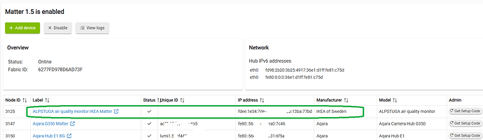

Please check first the status of your HE hub Matter interface. Go to Settings -> Matter Details.
Does the Aqara U400 have a green checkmark in the list?

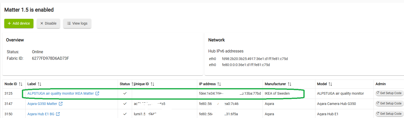

In the example below, we see the ALPSTUGA device being offline, and the next two devices with a green checkmark and filled-in IDs and IPv6 addresses:

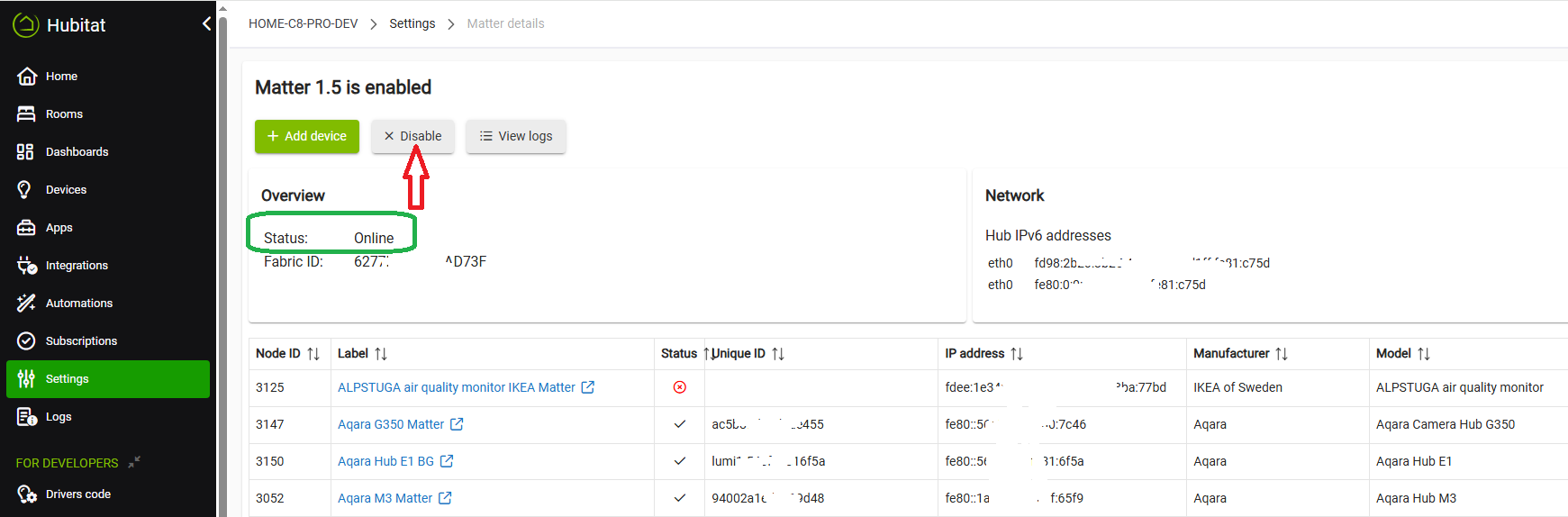

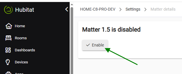

As a first troubleshooting step, you can temporarily disable the Matter 1.5 interface for 30 seconds
Then enable it again. Often, this disable/enable Matter 1.5 operation fixes the connectivity problems - as in my case! :

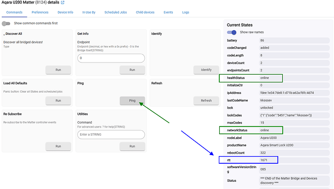

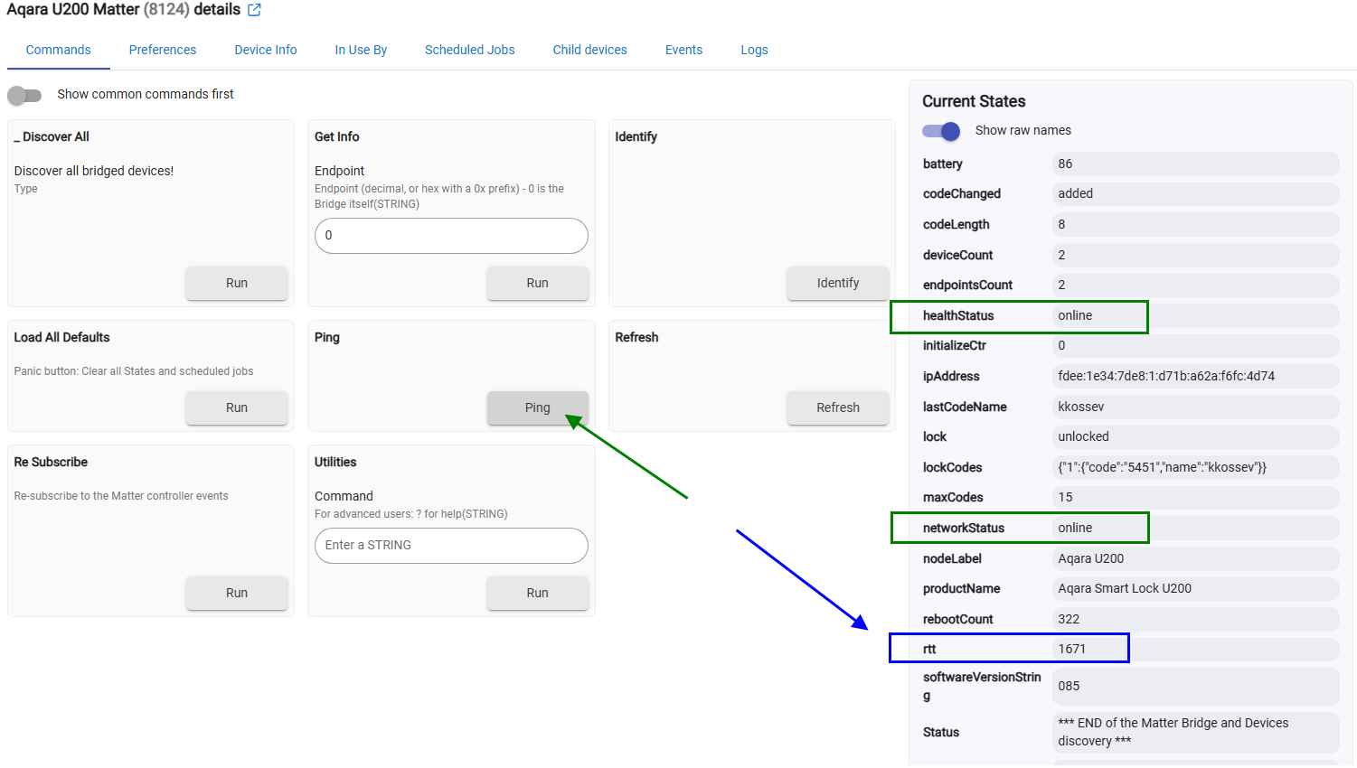

On the MAB parent device web page - click on the Ping() button. Observe the rtt (Round-Trip Time) attribute - does it show a nimber (time in milliseconds) or a 'timeout' error?
In the lates HE platform version there is a new system attribute, automatically injected from the platform - 'networkStatus'. Is it showing online?

  3. Ping worked fine
  4. networkStatus is Online
