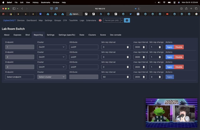

It looks like there are people struggling with it on other platforms as well: Reddit-Zigbee2MQTT
and they have found a solution, but dont know how to translate it to HE
