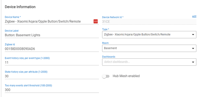

I've got a aqara mini button, I cant get it working as I dont know what option to choose from drop down menu of Type*
You'll need to copy/paste this driver in your DRIVERS CODE:

Then point your device to that new driver.

May have better luck w/this driver...there have been some problems reported using Markus' drivers due to (IIRC) it using some deprecated calls.
@levymarques777 - if you need help installing a community driver, see here:
https://docs2.hubitat.com/en/how-to/install-custom-drivers
Try this:
* Xiaomi Aqara Mijia Sensors and Switches:

I'll give this a try. Thanks for the heads up.
Thanks for you'll help, Ill try it out

Drivers won't keep (or lose) your devices to the hub, unless they behave very badly in general and in that case can affect other devices as well by overloading your hub. The driver I linked to won't do that.
If you have issues w/the device staying connected to your hub it will be because Aqara goes their own way w/their Zigbee 1.2 devices and thus Aqara devices can be picky about what repeaters they like and it won't be unusual to have connectivity isssues w/them. If you search here on Aqara you'll find discussions about issues w/them.
