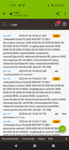

I am getting some serious 'noise' from my 2 aqara light switches (3 pole, no neutral). D1
I am using v1.0.1.1123 of oh la labs driver which I believe to be the current version
I was wondering if I have done something silly here? I was also wondering if an update to the H1 switch would fix it?
Thanks for any help that can be offered
What isn't working?
Try turning off logging for the driver if it's just the warnings you're seeing.
So the error messages can be ignored? It's not taking up a load of hubitat resources? I have disabled them
Thanks!
